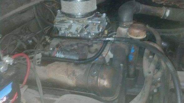

Ok, I'll work on that. Haven't seen those photos in years.

Thank you for reposting the pics. Good Ford Tough truck with that stance.
