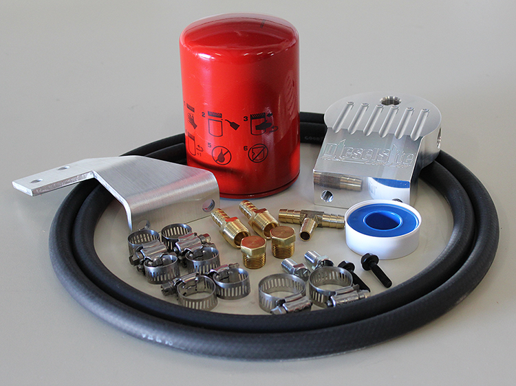

Rob, does that kit you have come with an aluminum mounting bracket vs the steel that comes with the sinister or PMM? I actually like the way the dieselsite base looks. I do prefer the silicone lines of the PMM kit however. I wonder if they would do one without the logo? It's not like you're driving around with the hood up but I really don't like the branding of parts when possible.

Yes, it is aluminum. The bracket I received was not the same as the one pictured above and was just a thin square with a 90 and holes. Looked a lot cheaper than the one above.
You could ask about the logo. I personally did not find DS very good at communications. I asked a couple of questions about other products and never heard back (maybe a victim of their own success). But they did ship quickly.

You can buy the filter head, valves & newer stainless steel bracket from DS. Order the hoses from Performance Machine. It will end up costing you more that way.
