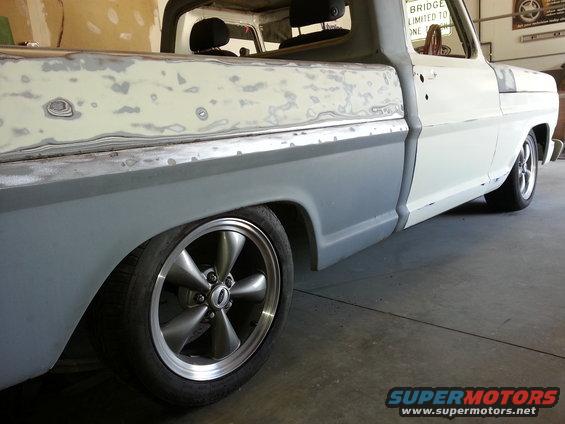

Here's a couple pics, hopefully they work:

Both sets look Sweet. Especially if you're gonna Flat Black It.
Thanks. It eventually will be a green though, similar to boxwood green. The box is covered in primer because I turned it into a shortbox this winter as well
Sorry, thread hijack over.

hvb68, that looks great! and thanks for the info. I just got some tires today so I can set the truck on its own weight. I went with 235/55/17, a used set just to roll around on and get a starting point.
No worries on the hijack, your truck looks cool! And that is the stock rearend with 2" spacers? I was thinking about doing that or getting an 80-83 f-100 rear. But it would be nice to keep the stock rear end for the time being at least.
