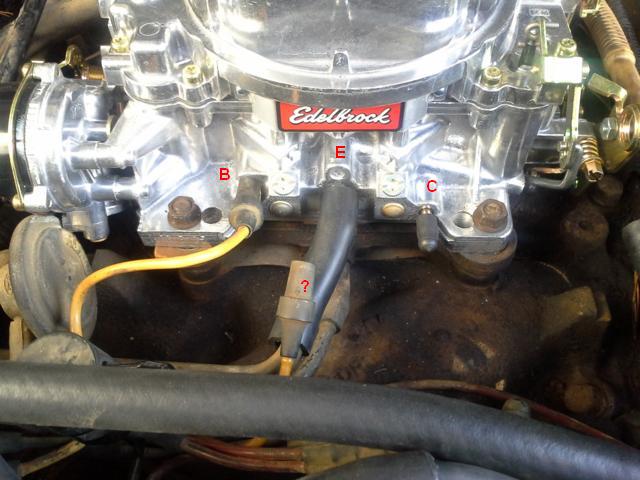

So this is where I am.
B on the Holley is now B on the Edelbrock and goes eventually to the distributor
E on the Holley is now E on the Edelbrock and goes to the PVC
C on the Edelbrock is capped
D on the Holley is ? on the Edelbrock and I don't know what to do with it
I removed the lines from bowel vents and capped the Purge valves like this.

Do you have the vacuum diagram by the radiator?
Old Nov 5, 2013 | 04:39 AM
Rovernut's Avatar
Rovernut
Joined: Sep 2012
Posts: 1,100
From: Georgia
I do, but it, and the one posted by David, show only one yellow vacuum line coming from the carb. That's what's throwing me.
Old Nov 5, 2013 | 05:22 AM
ArdWrknTrk's Avatar
ArdWrknTrk
pedant
Joined: Jan 2008
Posts: 23,576
Likes: 39
From: EXTREME southwest CT
One yellow and one white.
You see, the white line (B) has yellowed over the years.
Old Nov 5, 2013 | 06:06 AM
Rovernut's Avatar
Rovernut
Joined: Sep 2012
Posts: 1,100
From: Georgia
Hmmm..yeah, that could be. Sure looks yellow to me, but I'll look again after work.
Thanks.
Old Nov 5, 2013 | 06:12 AM
  #28
ArdWrknTrk's Avatar
ArdWrknTrk
pedant
Joined: Jan 2008
Posts: 23,576
Likes: 39
That was my vacuum diagram David posted.
I know that my white line is nearly indistinguishable from the yellow one now.
Old Nov 5, 2013 | 06:14 AM
  #29
ArdWrknTrk's Avatar
ArdWrknTrk
pedant
Joined: Jan 2008
Posts: 23,576
Likes: 39
'D' opens the charcoal canister purge valve.
You don't have the bowl vents anymore, but you do have the fuel tanks hooked up, correct?
