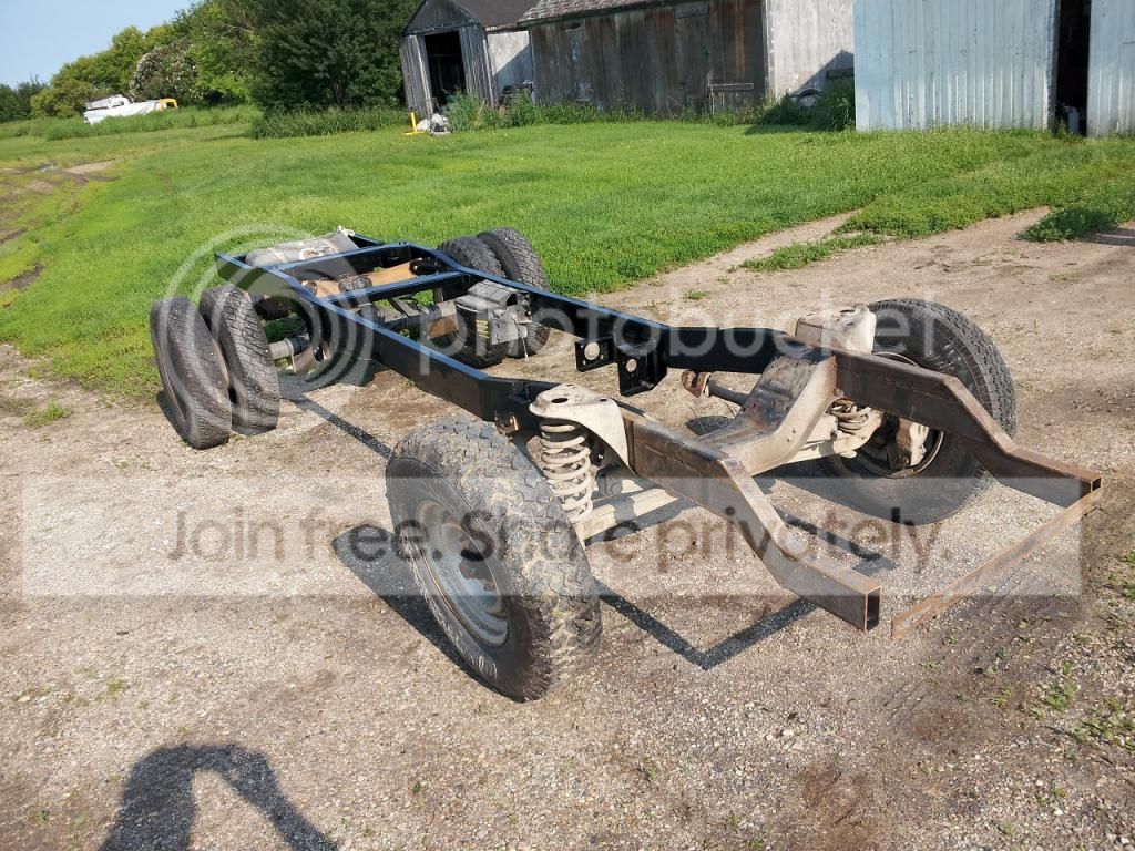

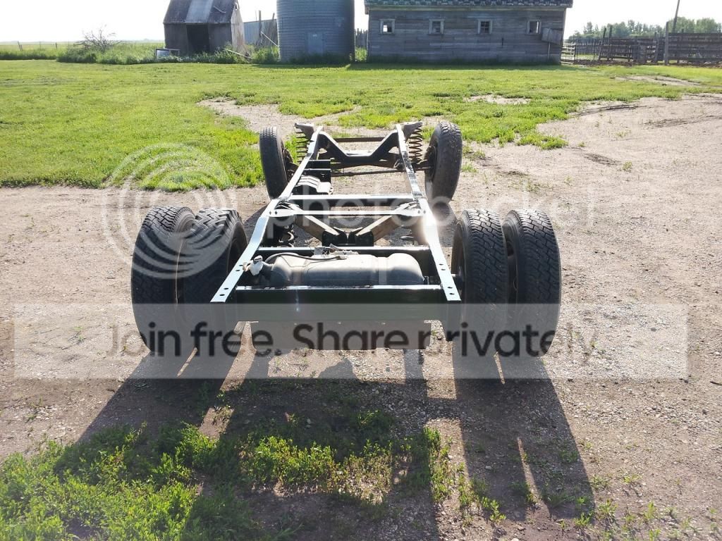

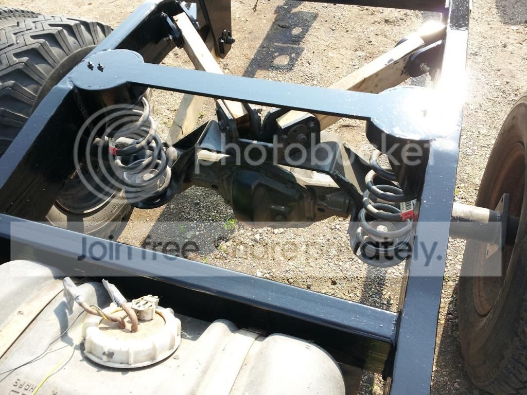

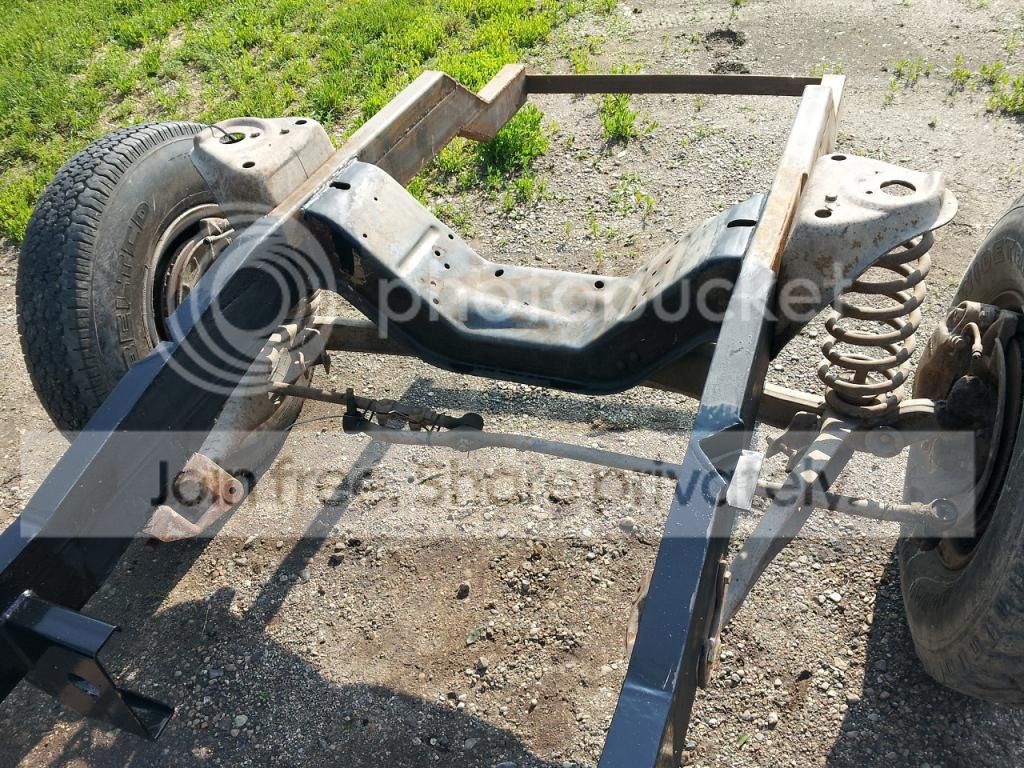

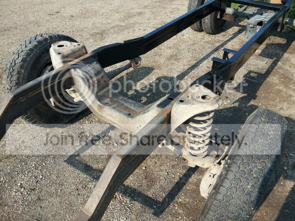

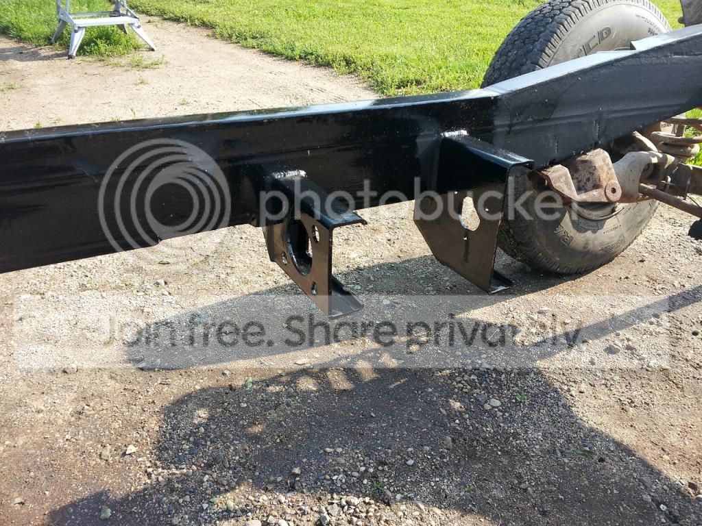

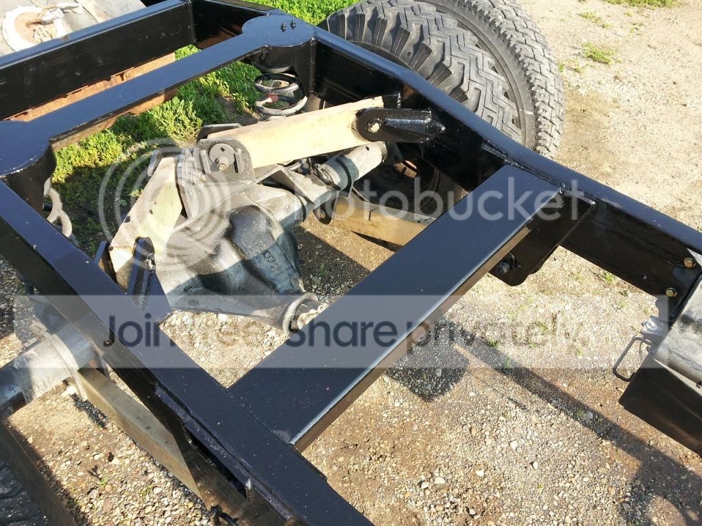

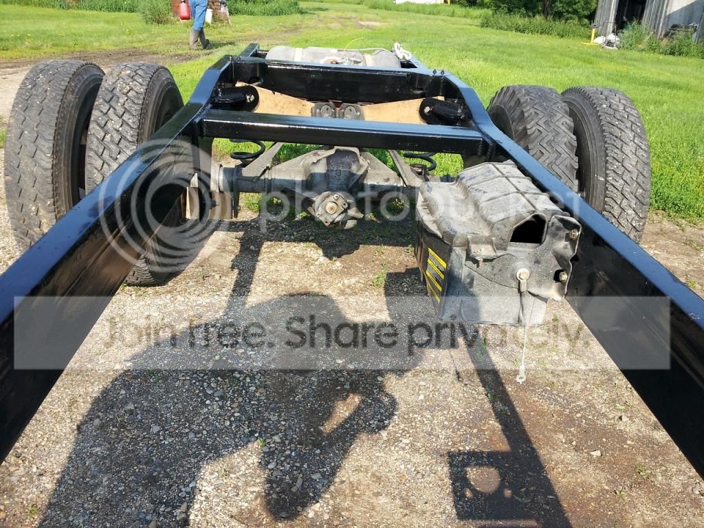

I know how everyone likes pictures but for some reason my phone defaulted to 640x480 and most of my digital camera ones were blurry. This is the progress of nearly 50 hours over 4 days.
For the running board brackets and other mounts I welded in threaded rod nuts, on the outside and inside the rail. I used these nuts as they provide lots of thread engagement.
The front suspension coil buckets are actually recessed into the frame 1/4" on each side. Again I welded in nuts to replace the rivets it had originally.
I picked up a new take off hitch from a 2011 F-250. It was wider than I needed to I promptly cut it up. Here is just the side bracket on the frame. I still need to remove the end piece so I can weld the center piece back in like it originally was.
Sorry for the darkness of these ones as they were taken when I got back to the farm and it was a rainy overcast day. The front suspension parts are just bolted in so the frame is mobile.

There is still lots of grinding to do plus I still need to put in the tranny crossmember, radiator mount, steering box and a rear shock mounts.

this is very heavy duty, BUT the rear control links appear to be make from wood 2x4's.....

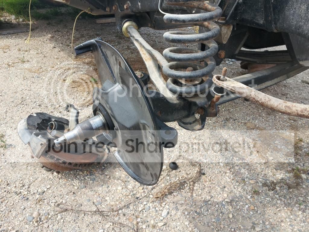

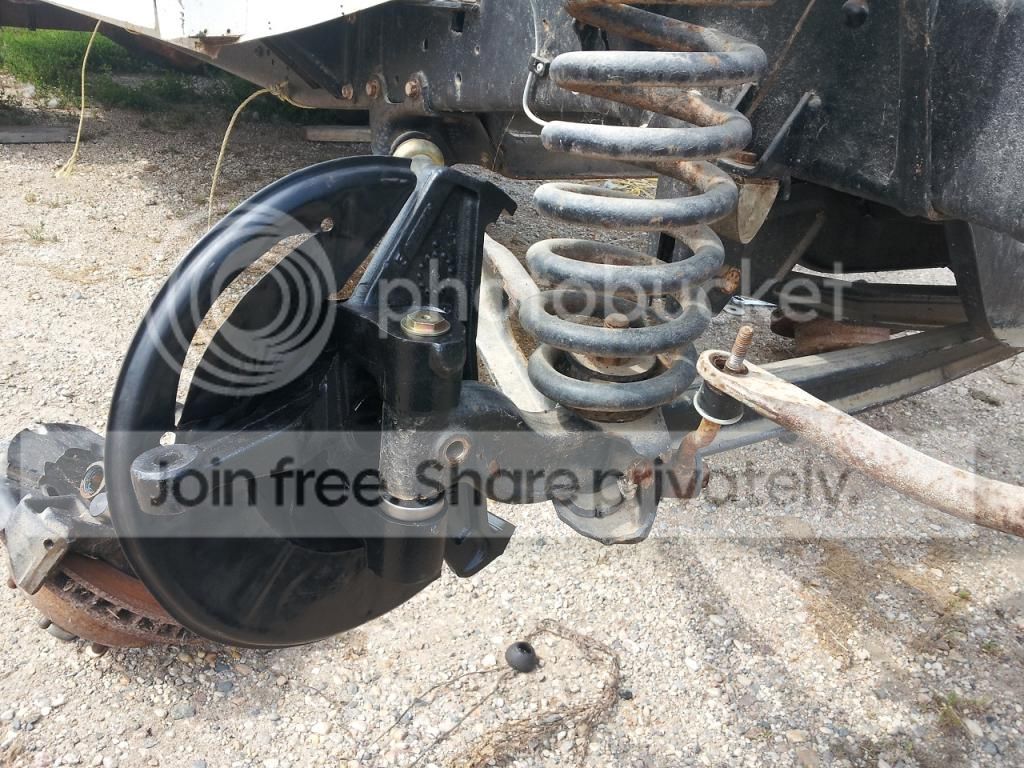

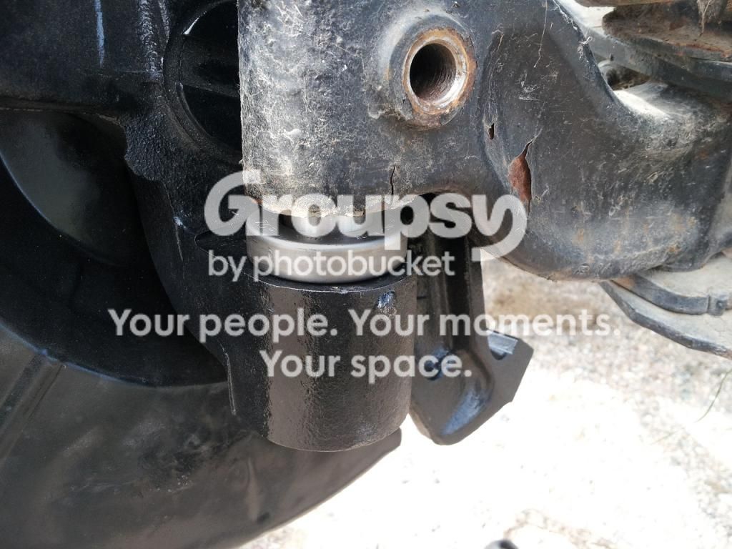

I finally got all the suspension parts I need stripped off the other frame and have a bunch of parts needing blasting/paint.
I finally was able to test fit my 1985 spindles to the 1978 beams. They actually fit pretty well. I only need to make a 1cm spacer for the bottom to make them work. Both spindles use a 1.054" pin and same lock bolt.
A little more progress a bit at a time.

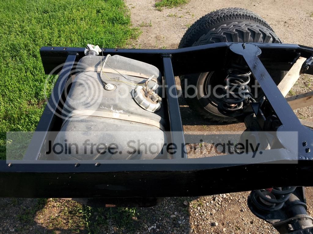

Here is the original 7.3L IDI diesel fuel pickup compared to the 7.5L gasoline pickup going in. I've fitted a Walboro 255 litre per hour Mustang pump to it. I had to raise the pump 3/4 of an inch since this picture as it hit the bottom of the tank.
The pump is now fitted to the tank. I also installed the fuel line to AN fitting adapters on.
