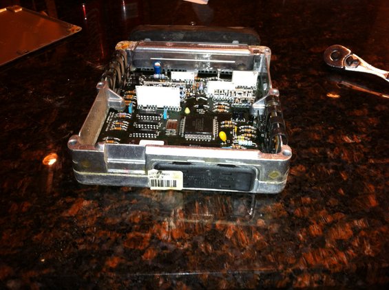

Just tried checking the codes again, and the light never came on....
So i pulled out the ECM and I have to say.... must have been a leftovers tuesday truck.
I've never seen a Ford ECM like this, unless it was on a the old school smart carb engines....

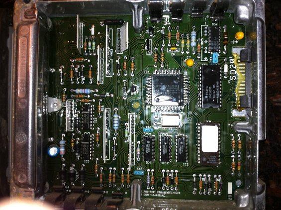

Cracked it open and no leaky caps. Now what?

Did try to get a close up of the only cap in it but my cam couldn't focus. There was no signs of leakage.

Does that have a ford part number on it?
That's like no other PCM I've ever seen in these trucks of any of the year ranges. Usually there are 3 of those capacitors, not just one, that's how they cause so many different intermittent issues.

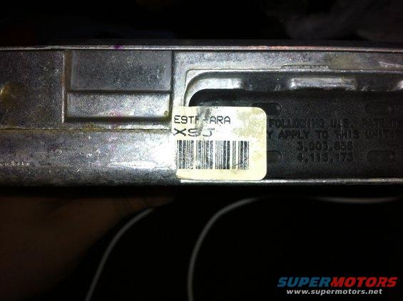

The top cover was stamped ford and there was part of an old ford part number sticker over the j port.
This computer reminds me of the ones that where used on the TBI set ups used in early 80s cars (vic, cougar, ect). But the internal parts are stamped with production date of 89...

I think you have the wrong computer there. I would suggest taking your vin number and calibration code (found in your drivers door jamb) and checking them here: http://www.motorcraftservice.com/vdi...l&type=EEFACTS
That will give you the original part number of the ECM that should be in your truck, then you can try searching images etc of the board inside to see if it matches yours.

It's the same computer that has been in the truck since my brother bought it back in 97, and the cap isn't leaking and none of the board is burnt. hwat i did find was the check engine light was burnt out last time i tried to get codes and instead of checking lights, fuses, and simple stuff i jerked the ECM out. So I don't expect it being the cause of my truck running like crap....

Looked up the E9TF code and found that this is a common used computer of F150s years 87-90 that had the 5.0L and auto trans. And, It has alwas worked has it should have, runing the engine, detecting problems and flashing codes that would lead me in the right dirrection for fixing any ailments the truck was having. This has been the first time, in which retrieving codes has not been helpful.
The link Jdan listed, states that i do not have permission to be on that page.

Not all of the truck computers had 3 capacitors in them. It all depends on what hardware code the EEC had to work with the program code. The 94 MAF EEC I have for my MAF swap has 2 capacitors in it.
