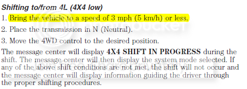

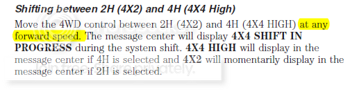

?? you most certainly CAN engage 4x4 HIGH while moving, straight from the '13 manual, see highlighted (page 219):
Now, 4x4 low is a different story:
However, keep in mind all of the following:
