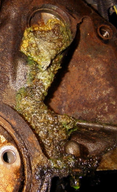

The 3.0l doesn't die easily. The cooling systems are the weak points on Aeros. Flush, flush, flush, then change the coolant every two years.
I had to replace everything on my first 3.0l that was cooling related: heater core, hoses, radiator, rear casting plug, pass side casting plug. Everything except the water pump.
Click HERE for larger
