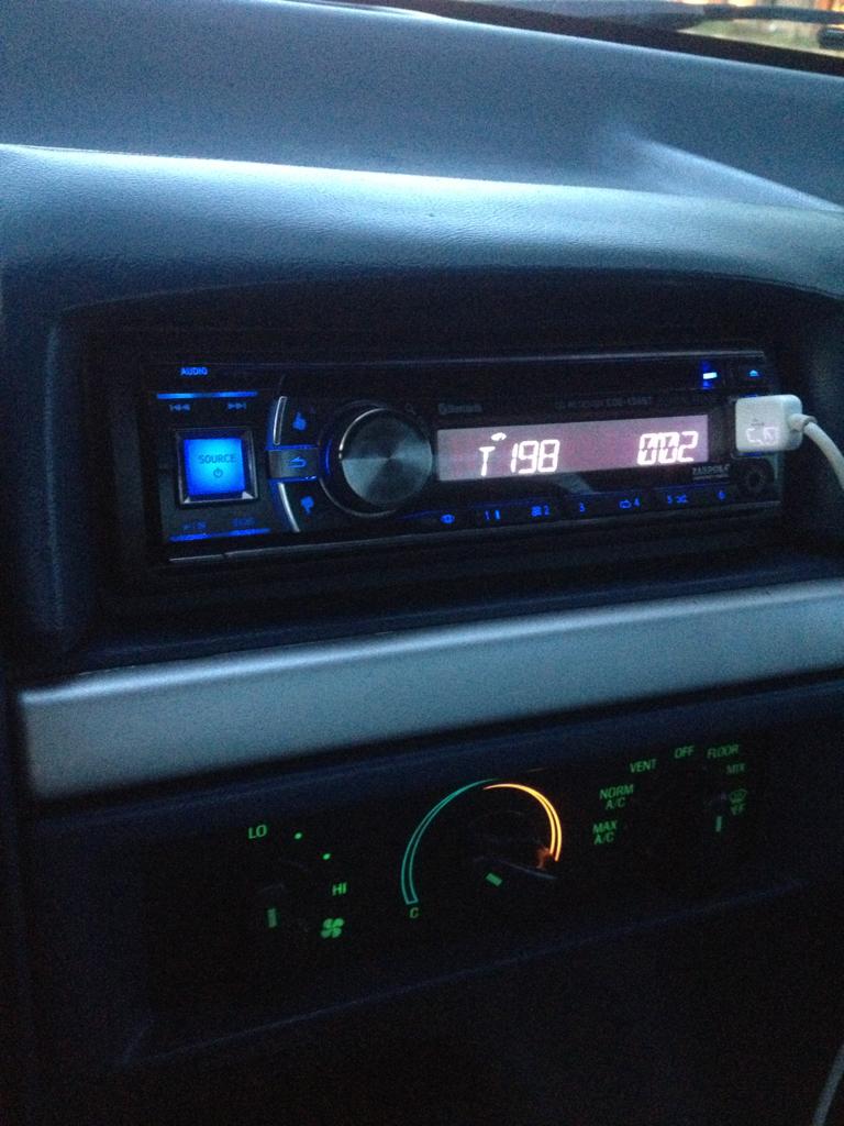

I'm a little undecided on if I want to go blue or white now. I want it to look good with this head unit.
I think just removing the film with stock bulbs will make it look yellow so either way I need better bulbs. Blue may be the way to go.

I would just buy blue bulbs. Here is what It looks like with no film and normal bulbs...
