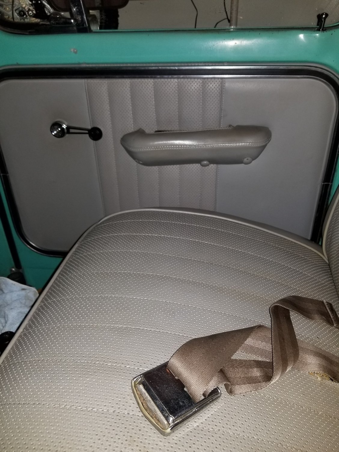

Really puzzling me. Interior looks all original. It's got grey seat and door panels, but tan seat belts, off white sun visors (no headliner), and what looks like dark blue carpet. It really looks like it came from the factory that way, based on wear and known owner history.
Did people in the 60's just go crazy with the colors?? Can I somehow confirm this is all factory?

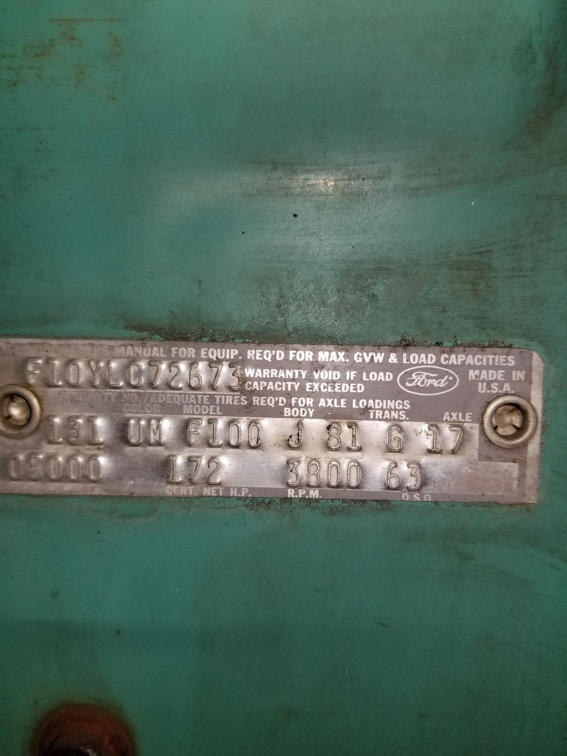

Vin decoder shows my trim (J) is F100/250 (81B) Pastel parchment crinkle vinyl and light parchment granada pattern vinyl.
What does that tell me? Trying to get this figured out and would really appreciate any help

I understand parchment is tan color. What I'm trying to figure out is what the difference is between light and pastel parchment. What parts are light and what parts are pastel. Correct seat belt/carpet/headliner/door panel/seat color.
I'm just trying to make sure the interior stays as original as possible as I restore it. So if there is anybody that knows, or knows of a resource for this, I'd appreciate it.

Yeah my dash is black and my column/wheel are parchment which look fine. But I don't know if the seat/door panels/carpet/belts are original and have just discolored over 50 years or what.

that's not Factory !
seat could even be stock for a 80s/90s ford and some one matched door panel covers to seat

Ok thanks, was pretty sure it wasn't stock seat cover and door panel covering. What might be under the upholstered door panels? Now back to my original question about my Vin plate. What does the J code tell me? I want to put everything exactly stock as it came from factory.

j= per fordification
J F100/250 (81B) Pastel parchment crinkle vinyl and light parchment granada pattern vinyl (1, 2)

MIKE'S, I saw that on the decoder previously but was looking for more specifics. Such as what the colors and patterns applied to.

F10 = F100 2WD
Y = 360 2V
L = Michigan Truck Assembly Plant.
C72673 = 1968.
131" Wheelbase.
UM: U = Lunar Green / M = Wimbledon White.
F100 2WD .. 5,000 lbs. GVWR
J 81 (F100/250 81B) (Note: For how I described upholstery locations, see M 81 below).
J = Pastel Parchment Crinkle Vinyl (upper section of backrest, lower section of cushion on front and sides of seat) & Light Parchment Granada Pattern Vinyl (lower section of backrest, front seat cushion (except as noted) / 81B = Custom Cab or Ranger.
G = C6.
17 = Ford 9" Rear Axle / 3.25-1 / 3,300 lbs. Axle Capacity.
5,000 lbs. Gross Vehicle Weight Rating.
172 net HP @ 3,800 RPM
63 = Memphis TN Ford District Sales Office, where the original selling dealer ordered the truck from.
1968 F250 2WD Ranger = M81 (F100/250 81B): M = Charcoal Black Crinkle Vinyl & Black Granada Pattern Vinyl / 81B Custom Cab or Ranger.
I bought this truck new, this is how the front seat looked, so I would assume that your Ranger would be the same.

NumberDummy, thank you that was very helpful. Do you happen to have a picture of your seat?
A​​​​​nd what do you think the door panels might have looked like new?
