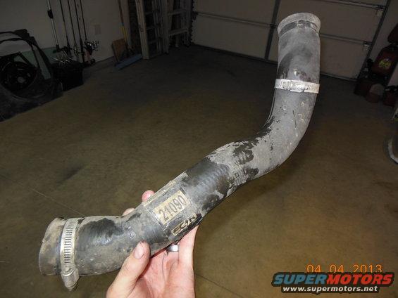

I know that when I did the radiator swap in my f150 4x4 I used a 545 and I needed a special lower hose for both 351m and 460. ECR/gates part # 21090.
