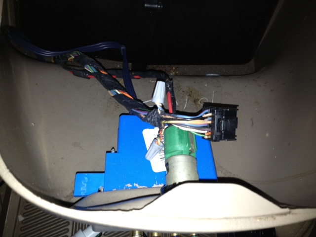

Yeah, I'm afraid of shorting something out if I jump the wrong wires. I think I'll just leave it in there:

You can try doing what I did. That AV outlet I installed is actually the same size as an electrical outlet. I installed a plastic electrical box to hold the AV outlet. You can install a 120V AC wall outlet instead.
For the wiring, you can get a standard outlet cord and cut it. Plug the cord into your power inverter and wire the loose ends into the wall electrical socket like you do when you wire one in your house. The wires to the outlet is protected in the plastic electrical box.
You can also see on the plug which wires I jumped to get the rear speakers back up.
I just realized your power inverter has USB outlets, too. You can get the standard wall outlets now with USB outlets, too. They have ones that has 2 USB.
I was scared when I tried jumping the speaker wires as well. What I did was I used my mp3 player with headphone jack plugged in with bare wire ends. With the Excursion powered off, I tapped the speaker wires from the diagram until I heard music coming out of the speaker. That was when I knew which wire I had to cut.
