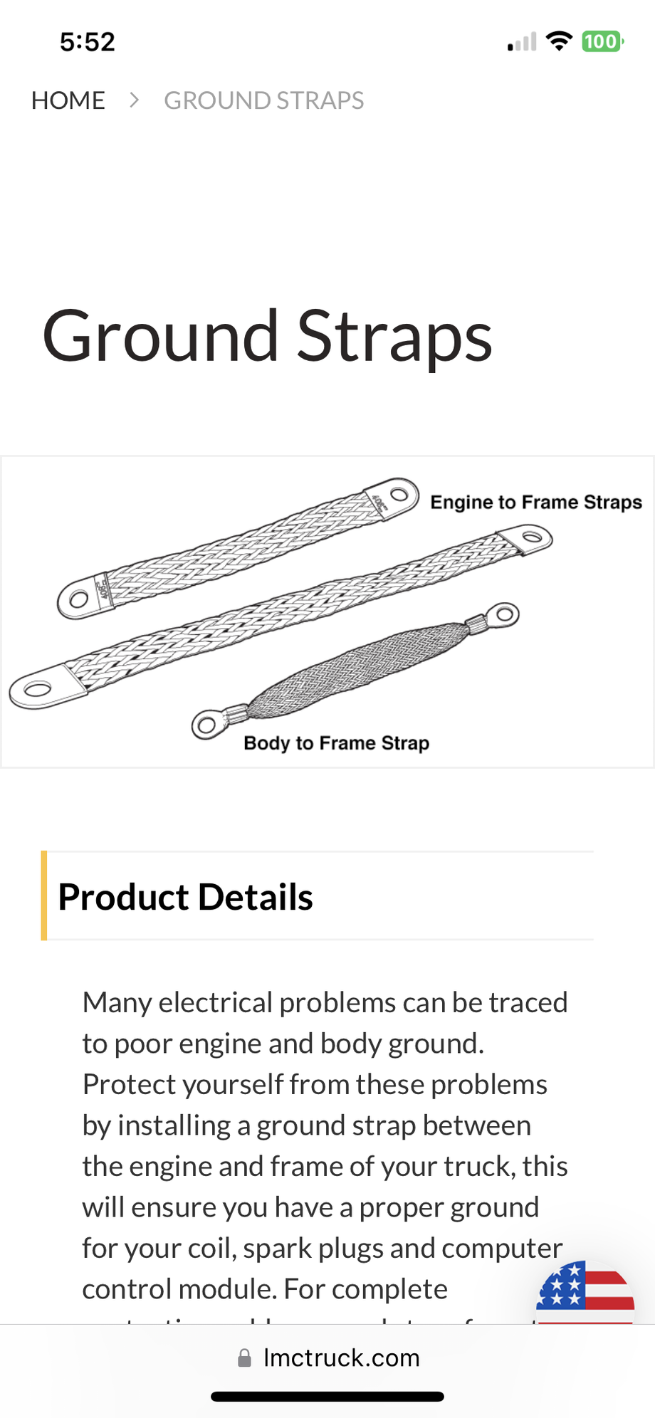

Old Jul 23, 2023 | 05:12 PM
fun4evrusa's Avatar
fun4evrusa
Joined: Dec 2014
Posts: 64
Black Cable Grounds
Where did you find those Black Cable Grounds? I am at this step and need to find some. Thanks.
Old Jul 23, 2023 | 06:08 PM
FuzzFace2's Avatar
FuzzFace2
Posts: 30,828
Likes: 4,094
From: Angier, NC
You know this is from 10 years ago right?
They look like battery cables to me.
Dave ----
Old Jul 23, 2023 | 11:23 PM
mikeo0o0o0's Avatar
mikeo0o0o0
Joined: Apr 2009
Posts: 14,333
Likes: 247
From: Stanley, VA
Dave ----
Yup, they're starter cables with an eye on each end. These usually go from the starter solenoid to the starter.
Old Jul 24, 2023 | 04:53 AM
markwoten's Avatar
markwoten
Veteran: Navy
Joined: Nov 2013
Posts: 112
Likes: 11
From: Bellefontaine Ohio
Grounds
Dave ----
Most automotive parts places have what you need. LMC has the correct OEM a few that will do the job.
F-250 restorer
