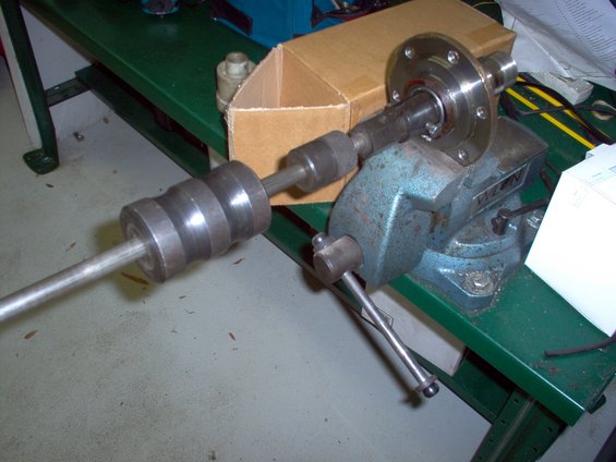

Do you mean this ?
If you are talking about the little spindle bearing then a slide hammer has always worked best for me

It is an adapter for the slide hammer
like this kit http://compare.ebay.com/like/180905658519?var=lv&ltyp=AllFixedPriceItemTypes&var=sbar

This may be an easier to locate and cheaper way to go than to find the adapter for the slide hammer How to remove Dana 60 front spindle bearing??? - Pirate4x4.Com : 4x4 and Off-Road Forum

That looks like a very handy tool to own Redroad. There is a HF in Salem, VA. The next time I go to the VA Hospital there, I will get me one. As for now, I got it out. I couldn't get enough of a bite on top of the bearing, to get it out with a drift. I was, however, able to catch the bottom lip with the drift, and break of a small section. At which time, all the bearings fell out. I was able to very carefully complete the rest of the job, with a special tool called a Dremel Tool. LOL. While I was in the automotive trade, as a proffession, I learned that, if at one point, I needed a certain tool, there would be another day that I would need it again. So, I would go ahead and buy the tool, rather than borrow it.
