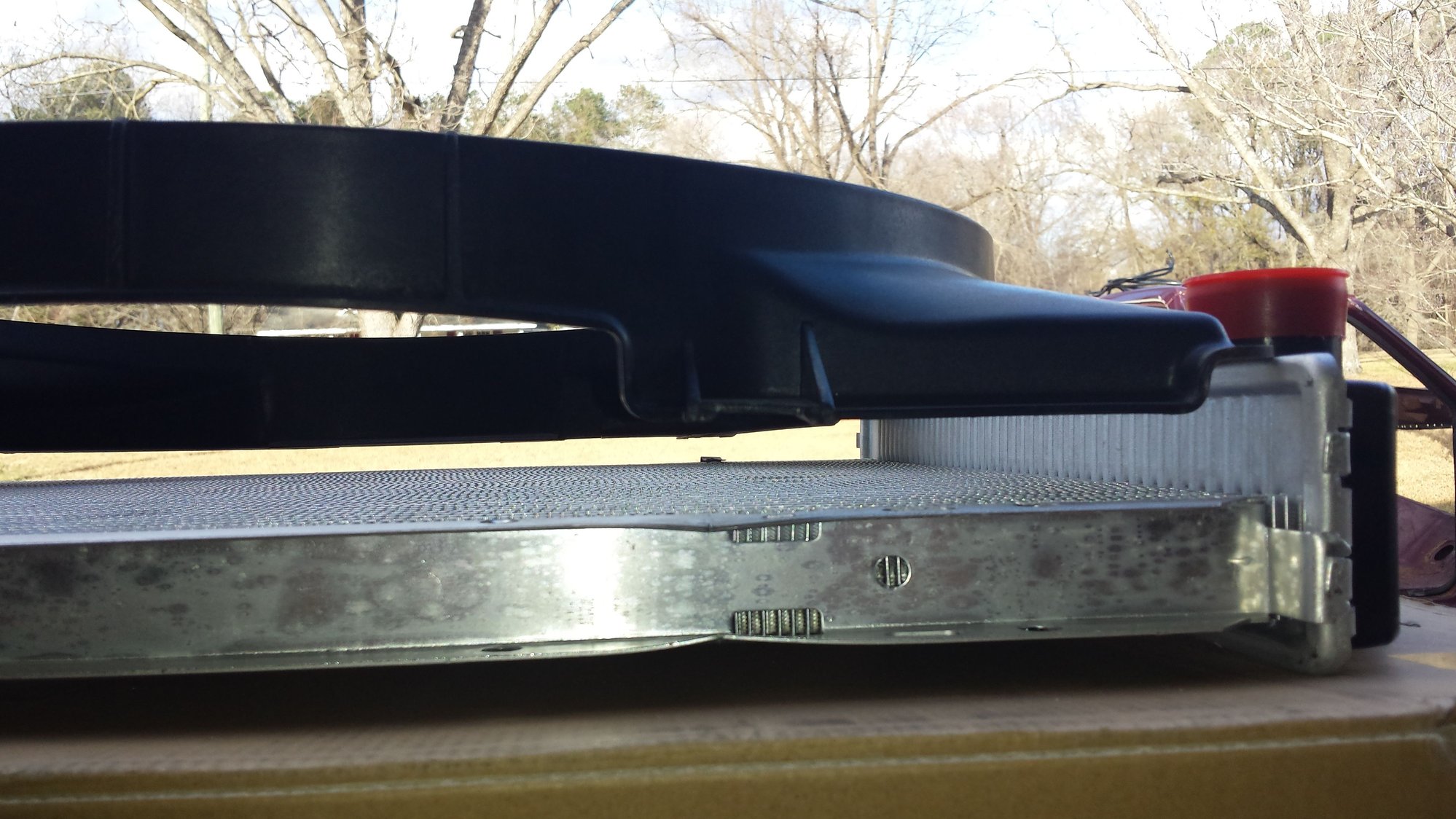

As you can see that is the later radiator with the tabs on the tanks to bolt to the support.
