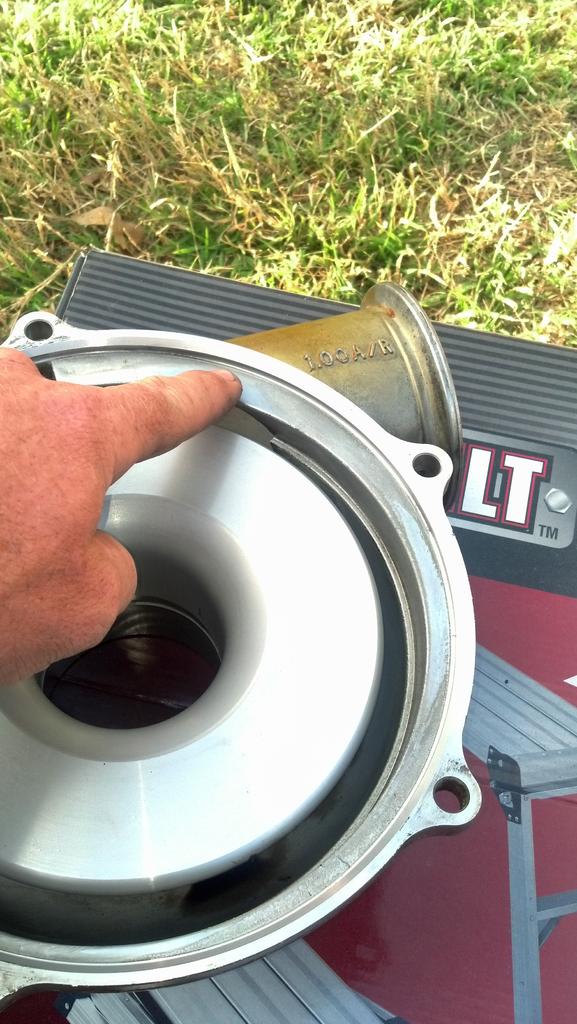

I just removed and rebuilt my turbo today. What are you talking about when you say "the two halves"? We seem to be confused. There are three parts to the turbo. compressor housing (aluminum part you see all the time), the center cartridge and the exhaust housing. You can't really see the center cartridge very well while it is on the truck, and you can only see part of the exhaust housing. Both of these are cast iron. You have any pics? I just posted some in the thread I am running while I am doing my weekend mods and maintenance.
If you are talking about the compressor housing, yes...there is a gasket that fits in between the "two halves". Some people add silicone in there with the gasket for a better seal ( I do not). If that gasket is missing, you will get oil from the CCV spin out between the back plate and the compressor housing. There will never be soot in that area.

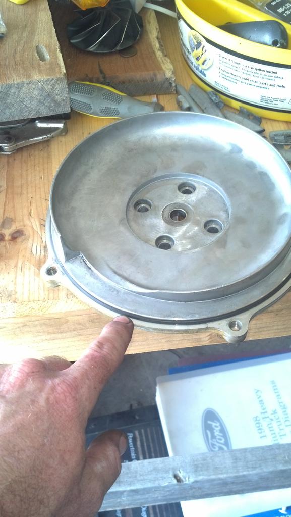

Compressor housing...I'm pointing to where the oring seals in on the edge

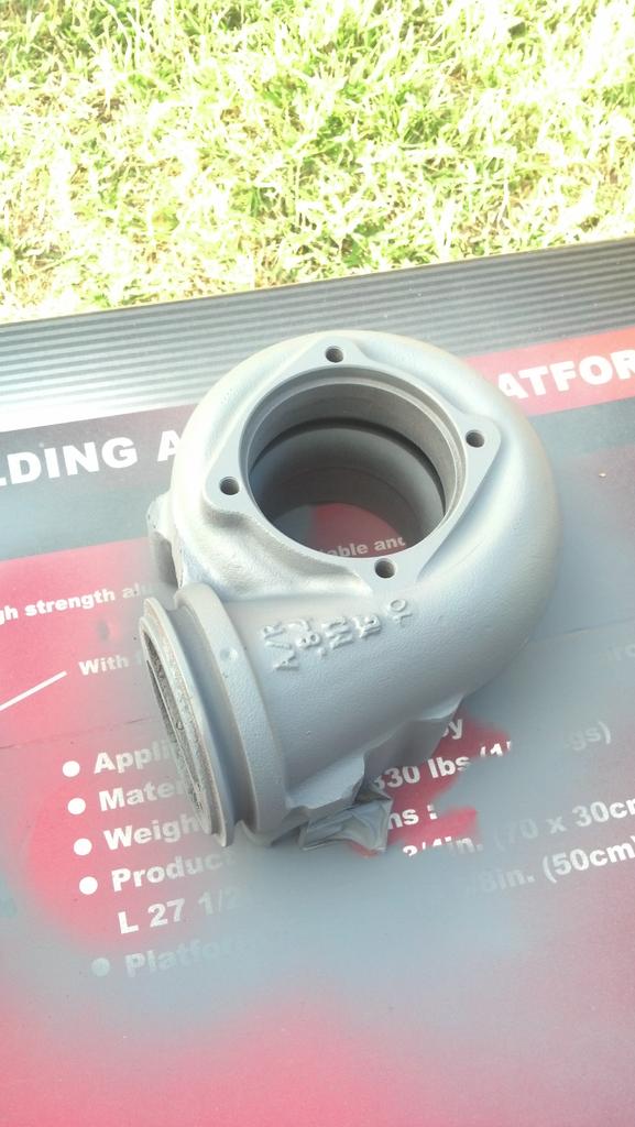

The exhaust housing

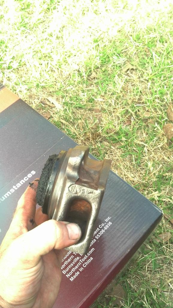

Center cartridge

And the compressor housing back plate with oring installed

Originally Posted by huntke
It's not on the backside....... I haven't looked real close yet might be some there also. Its where the two halves come together. Is there any kind of o-ring or gasket there, or just bolted together and the bolts are loose, or broken?
From what you are describing it sounds like one, two or more of the bolts that hold the exhaust housing to the center section may have loosened up or come out. There is no gasket or seal in this location.

I am impressed you took time to take pics. What kind of paint are you using on the exhaust housing?

The last turbo I worked on had all 4 bolts backed out on the exhaust housing. There was just a SLIGHT exhaust leak there......
Black Rustoleum 2000° high heat on exhaust housing and DEI hi-temp 1500° silicone coating on compressor housing (aluminum colored). I will also be using that silicone coating on my up pipes
