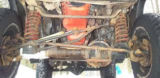

Sorry.. my bad, I meant less movement when the suspension cycles. Imagine one wheel cycling and then track what it does to the other wheel. The T-style is less susceptible to movement because the tie rod links each wheel to each other rather than the movement transferring through the drag link.
T-style:
Y-style:
