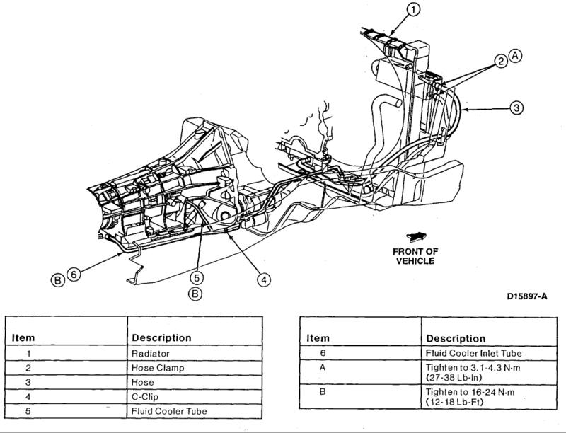

Best I could find.

I'm hoping someone can take a pic for me tomarrow during the day. I've got to drop off my driveshaft tomarrow to get it shortened 75 bucks plus parts not bad at all. But I'd like to install my new tranny cooler but I need to get these lines figured out first

It looks like there's a bracket that mounts to the engine of course I don't have it looks like I'm tearing apart the garage tomarrow haha

Originally Posted by pjwoolw
Best I could find.
Attachment 70049
Very good image.
