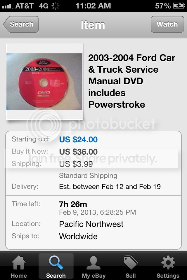

Hey Doane, go on ebay n get a ford DVD. It will answer all ur questions.
Get the one for your year,, obviously. You just set the date on your computer to the date on the DVD. Here's an example
