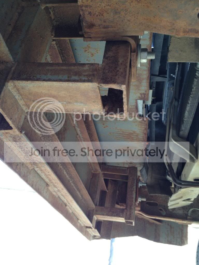

First off, does anyone have any knowledge of this bumper? I don't believe it is original equipment, but I really wouldn't know. I looked all over for a tag or label or something, but found none. It is a treadplate surface over a welded steel channel frame.
As you can see from the underneath picture, there is quite a bit of room under there and I'm thinking of possibly mounting a winch behind the bumper and cutting a slot in the front of the bumper and installing a roller fairlead. However, as I'm quickly gaining much respect for the experience, etc of the members of this forum, I'm tossing this out to see if any of you have any opinions, recommendations or ideas you'd be willing to share. I appreciate anything helpful in advance...

Homemade/custom built, what were your concerns again.

IMHO, You're going to need to reinforce those brackets if you choose to run a winch.

Thats pretty bad......

The welds themselves look solid, but no attempt was made to box the ends of the channel.
The bolts look like Grade 2 garbage.
The angle bolted to the frame horns is a joke.
But it wouldn't take much attention to detail to fix it right.
Agreed...it nees horizontal reinforcement...otherwise visually from the outside its ok...

Yep, I was wrong, definitely home made. But these guys here are right, it needs some attention. But it looks good otherwise.

I agree, I think it is a bit wanting. My idea was to possibly mount a winch through the same bolt holes that tie that bumper to the frame so it would be attached to the frame for a good solid mount. I suspect that would probably take some custom built bracket to adapt a winch to the frame. I wouldn't expect the bumper to either carry the winch or have the strength for any serious pulling. I'm just hoping there's enough room so the winch would be covered and somewhat protected from the elements.
That is the essence of my idea...
As a while I'm at it, what would you guys recommend to fix the bumper up and make truly as tough as it looks?
