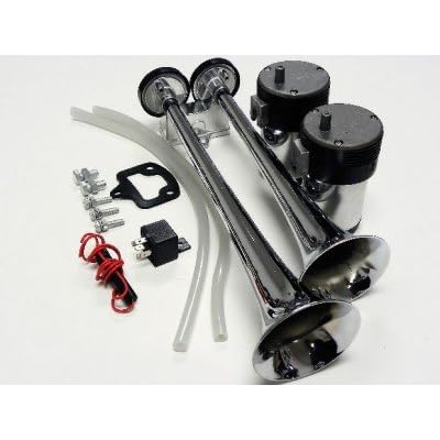

Been wanting to do this for years, but never got around to it 'till just recently. I installed a set of train horns earlier this month. I didn't get the full blown set with the compressor and tank, but these have individual compressors for each horn and they are plenty loud.
I did a couple of things different on the install over what the installation instructions indicated. I replaced the wire that came with the kit with some heavier gauge wiring and tossed the fuse assembly for a heavier duty, water proof flat fuse instead of the glass tube fuse supplied, and I added a secondary switch so I still have the factory horn hooked up to the steering wheel. I didn't get the factory trailer brake controller so where it would have gone in the dash was simply a slot I used to put my cellphone, business cards and crap like that. I installed a red button inside that compartment so that it was out of the way and obscured from view.
While I had it all apart, I installed my phone cradle and added my cellphone booster as well, mounting a low profile antenna on the windshield.
Anyway, the horn is a novelty, but I've been able to scare the crap out of some people on more than a few occasions, and am waiting on the first idiot sighting on the road to remind them to get out of my way. The only downside to it is now every time my son gets in the truck, he finds tons of people and things to blow it at.

I installed them in front of the radiator, right in front of the factory horns.
I didn't hook them up to the horn on the steering wheel opting to keep the factory horns usable. Instead I installed a "special" red button in the cavity where the factory brake controller would go.
A little closer view -
I got these off Amazon. I looked briefly there but couldn't find them still there. The graphic in my original post shows the kit.
If you do the install, use heavier gauge wiring and a heavy duty fuse holder instead of the one that comes in the kit. The one included in the kit is a tube style buzz fuse and the wire leading to and from the screw in, inline fuse holder is substandard. A buddy of mine installed the same kit on his Dodge using all the wiring that came with the kit and kept blowing the fuse. He went above and beyond and installed a 40 amp breaker.
These are as loud as I think I could find without going to the full blown compressor models. Each horn has its on-demand compressor. Most other kits I saw had one on-demand compressor for multiple horns. It I ad to this, I'll make sure I get another on-demand compressor for the third or fourth horn. Right now, it will get peoples attention for sure. I can't tell you how many people I've made jump through the roof with them!
