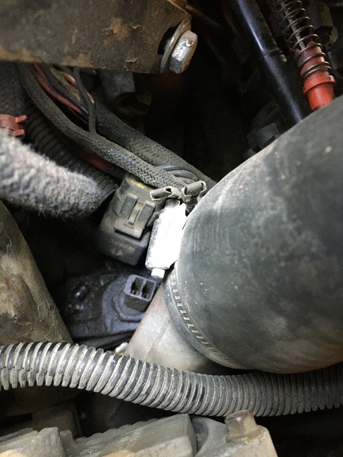

My wire connection came out of that coolant temp sensor, can I just plug theses two connectors back in? Does it matter which connector goes in which slot of the sensor terminal? The two plugs leaning on the hose clamp.
