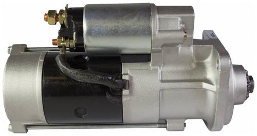

I did a little CSI work.
Here are the sources of the pics: O'Reilly's website
I searched them using the '99 and '01 7.3 applications.
The first 3 bolt Mitsu starter pic (enlarged image) came from here: Ultima® Select 35154 - Starter | O'Reilly Auto Parts
The second one came from here: Motorcraft SA817RM - Starter | O'Reilly Auto Parts
Based on what we know, so far, the 2001 year model 7.3 trucks could have a 3 bolt Mitsubishi (like mine) or 2 bolt Nippondenso (like Les).
Look here for Amazon.com: 7.3 nippondenso starter solenoid and a plunger/contact repair kit for the 2 bolt Denso.

As I thought.
Though they may be different sources, different manufacturers, and different quality parts in them, they are both the Mitsu design, planetary-gear types.
Could be used interchangeably, but with probably different long-term results.
What I find funny is the genuine Motorcraft unit is a limited one-year warranty, and the Chinese knock-off is limited lifetime.
Warranty doesn't matter to me. What I really want is reliability!
What's harder to know is whether they come off the same assembly line or not.
