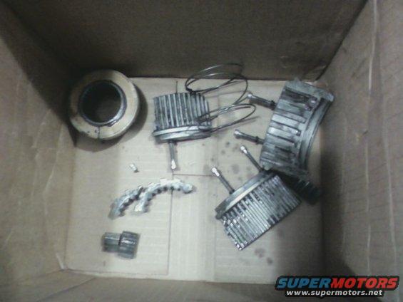

Warn lockout hub.
I put in drive flanges after that.
Than I did stuff like this
(Top shaft is my D60, bottom is a D44)
This one broke the outer shaft right where the shaft came off the yoke, than the yoke flopped around and wedged in the knuckle n broke the inner shaft.

I did this with stock hubs for whatever its worth:
The splines were twisted on the shaft but a press revealed that the stock hub locking ring thing was fine.

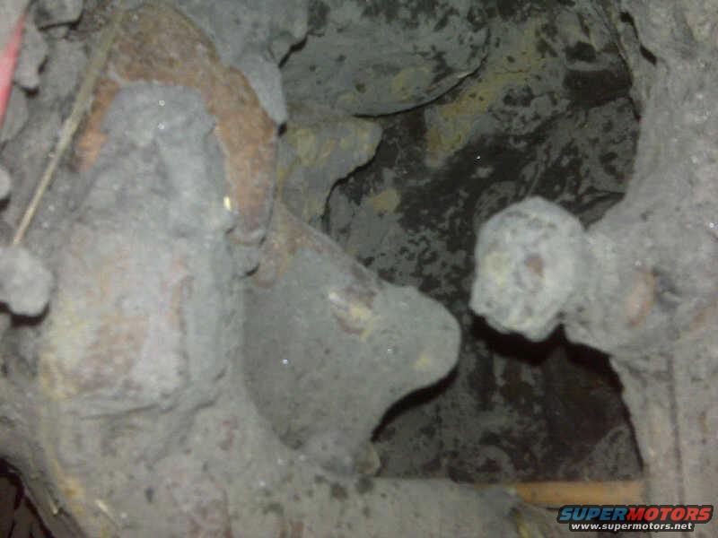

this is from a 44 with welded spider's hopped up 460 and 38's, landed on the front tire from atleast 3 foot of air at 6200 RPM in second....
then this was from bout 2 week's later when i left the line....
This is why they got welded anyways..
