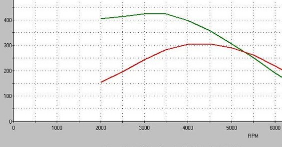

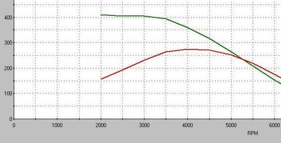

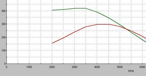

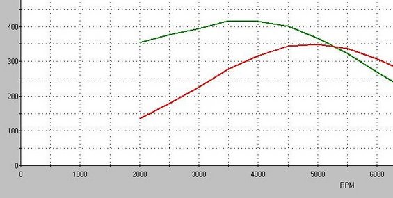

Here are some Desktop Dyno 2000 Runs with Same engine 351W, GT40 heads, small tube headers, same intake flow and SEFI fuel injection. Note that DD2000 is optimistic by about 13%, so 400ftlbs becomes 348. Note that there is little improvement over the stock 96 roller cam and that the improvement for the comp cam is gained up high in the RPM range but some is sacrificed on the low end. Also note that all of these cam allow the engine to run with your stock computer with MAF.
Ford F4TE (stock 96 roller cam):
Crane 2031:
Crane 325-2s-12:
Comps 35-312-8:
