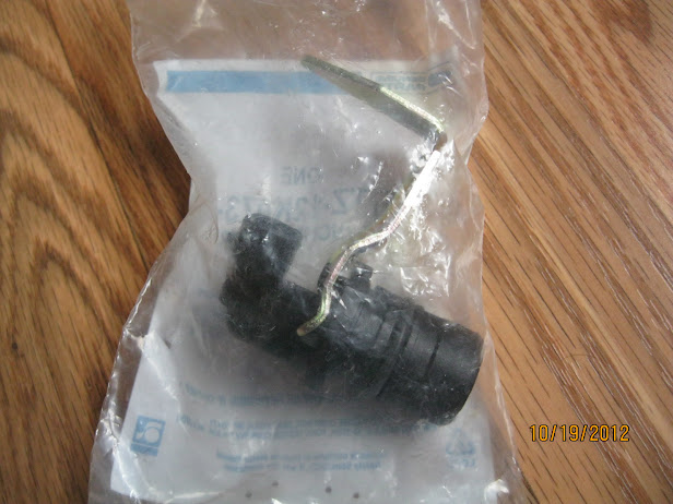

So I am guessing this is a black one then?
Seems I have a hard time telling the difference between what folks call the "black" one and the one they call "dark gray", although the gray one usually has a purple o-ring doesn't it? This one is a part number F7TZ-12K073-A.
Old Oct 19, 2012 | 04:37 PM
427 fordman's Avatar
427 fordman
Joined: Feb 2009
Posts: 10,408
Likes: 75
From: Plankinton, SD
Ya, both my dark gray ones (one ford, one IH) have the purple oring. I'm saying that's the black one.
