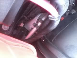

This thing is really giving me a headache now, had a friend over wrenching on it too and we can't get it to budge.
Tried PB Blaster, a wrap around filter wrench, and today the locking pliers style filter wrench... still no luck! The pliers style was starting to indent and score the filter pretty bad so I stopped.. hopefully it will still drive, no leaks.
Any other ideas? I have no idea how it could even be stuck on this good.

Ok just making sure it's not going to rip through the side of the filter, what are the chances of that happening? Because that's what's deterring me from doing the screwdriver trick, don't want to end up not being able to drive and having an even worse problem on my hands.
Oh and I'm turning it the right way, over toward the air filter to the right looking down on the filter housing. Still can't get it to budge...

Are you saying that looking down overhead, I'd be turning to the left? Because I've been turning to the right all of this time. I'm standing over on the passenger side and clamping my wrench on and then pushing it toward the air filter (turning to the right).

Ok cool, so I am turning it the right way.
I'm considering doing that, Onus, but I'd hate to make this mess worse by having a hole in the filter and still not being able to get it off, or having the filter tear.

Lets get this straight. Leaning over the pass. fender with the handle of the filter wrench pointing at the radiator, pull towards the pass. fender.
