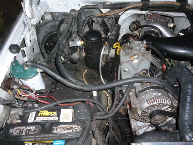

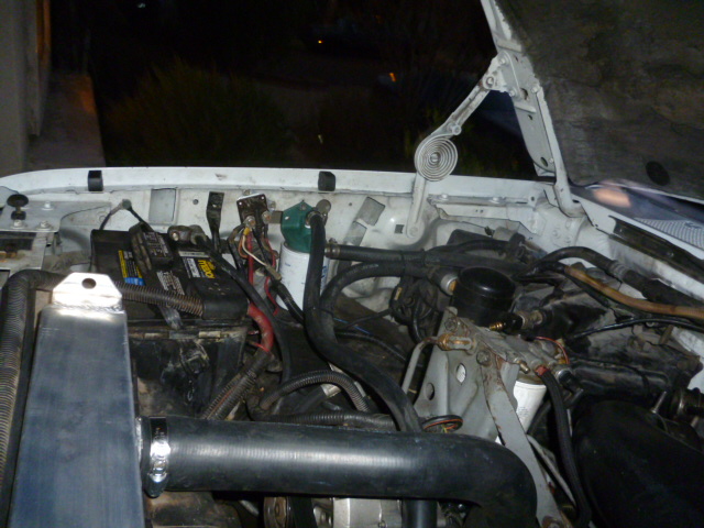

Go through wix they are exactly the same at half the cost. Mine is as simple as it gets. I moved a relay, and mounted it to the pass fender right in front of the hood hinge.
Name:  Re-routed coolant filter 003.JPG
Name:  Re-routed coolant filter 005.JPG
These are older pics. I have now added a trans fluid t-stat so I removed the heater hose tee to the bottom of the radiator and re-routed the hoses and it looks even cleaner. I'll try to add a new pic. A lot of guys add shut off valves for changing the filter, but with it located here, there is no need. It is at the highest point in the system. I can remove my filter, and lose maybe a quarter cup of coolant. I even solves that problem by putting a plastic bag over the filter before removing it. I can pour the overflow right back into my expansion tank. Just make sure there is no pressure in your system first! So you know, supply is from the head port (goes to inlet side of filter head) outlet goes to the water pump.
I don't know how much it helps, but it sure can't hurt.
Good luck,
Mac.

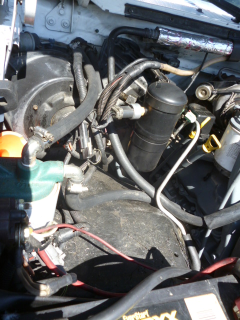

I can get it off pretty easily. Hold the filter head above a filter, so you know you have enough room to remove it then mark it and screw it right into the fender with some large SMS. Make sure you have clearance for the hood hinge, and remember the head port goes to inlet side of filter head, outlet goes to water pump. Here are some current pics:

As you can see I was able to free up a lot of space over the fender well by putting it here... I'm thinking custom cold air intake??? I need to get rid of that factory POS. I'm even considering a hood scoop for it??? Hmmm.
Good luck,
Mac.
