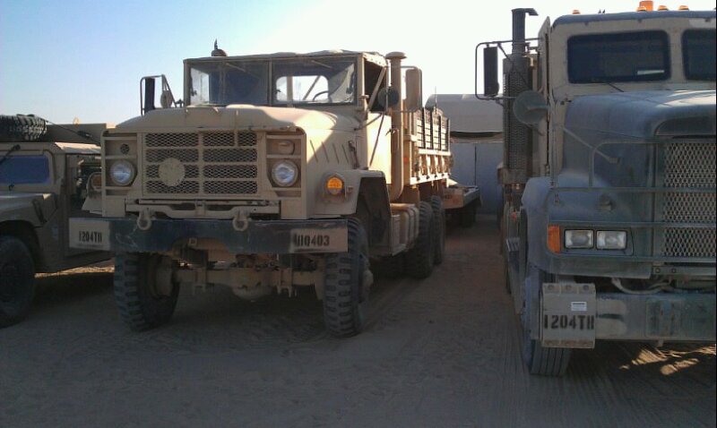

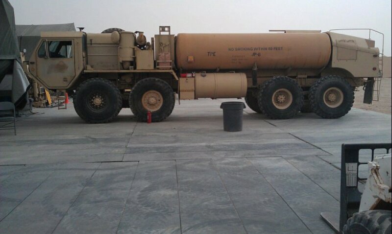

Thanks for the info Fellro. I really need to get into my truck a little more so I can figure all that stuff out, but for the time being these are the type of vehicles I tend to work on.

The 5 ton is my assigned vehicle. Most reliable truck we have had this year.

The pictures make one understand how Ford terms these things "Light Trucks."
