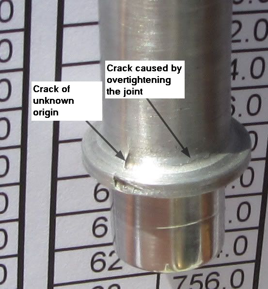

Finally Fixed
I replaced the condenser coil and that fixed the leak. It was a rather expensive lesson, as I probably spent about $400 before solving the problem.
It turns out that the condenser coil has TWO cracks at the fitting. One which I caused by over-tightening the joint, and another that was probably the source of the initial leak. The latter is either a vibration crack or the part was perhaps miss-formed during manufacture.
The attached photo shows the two cracks. Does anyone know of a kit that replaces the fitting end of the condenser? For a $ 30-40 kit, I'll keep the old condenser as a spare.
As an aside, When I have to "top-off" the Freon in my AC systems, I'll be sure to use the Freon with the UV dye. It works great and really makes finding leaks easier.
