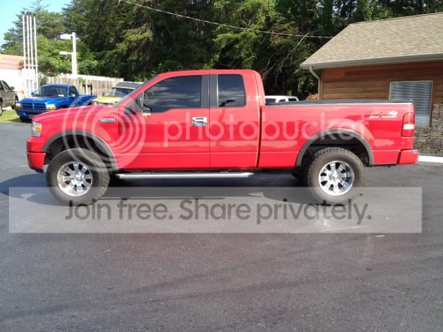

I'm thinking about trading my wifes Toyota van for this tomorrow, she found it at a local car lot and fell in love with it.
It is a 2005 Ford F150 with the 5.4. It does have high milage, 133000 to be exact. But it runs great, way more power than my 2001 F250 with the 5.4. I'm sure being a half ton and a few years newer helps with that.
Is there anything concerning about these that I need too look for? Never owned a F150, just SD's.
Thanks...

Sweet looking truck. Super quiet under the hood? Check the oil.

It is really quite under the hood, the oil seemed clean for the miles. Is there something I should look for with the oil?
Sorry for all the questions, I would just hate too trade her perfectly good van for something that may be bad. My 5.4 has been a good one so far, is the newer ones better? I know I have read where mine has the spark plug thread problems, did they correct this?

You can read all kinds of threads about the misfortunes of the unlucky few. Around 2007 they corrected the weak spark plug, the 2005 may have them in it. I wish she had 70,000 on it! Don't know the year of the van, are you soccer parents or grandkid raisers? LOL I have a couple of those, and my 2011 3.7L is great for them, they watch DVD's and we go places. Driving about 600 miles a week with it now at 15,250 miles. Averages 19.9 MPG since new. Only way to go. Ha ha. I would recommend the XL x2 for you to. Just kidden.

The 5.4 can be a tuff cud to chew if it goes bad on you. The older 16 valve was a reliable motor just needed a gallon of gas. People who have good 3v's swear by them and the ones who throw the cam chains guides and all the other VCT stuff hurt. My next move will be a crew cab F150 when the kids are pushing 7/10 years for less bumping in my back. By then my 11 will have 70,000 or so on it. It is a scab, roomy enough for em now. Maybe just take the risk and go get a new crewcab and keep the Toy a few more years. You can use it with the business, and wife can beat around in the new crewcab. LOL a win/win. Mine loves to make the statement, "I'll take you downtown"! She loves to beat around in my trucks. Its the curbs I worry about most.

I guess the real knowledge to have is the Red machine is right in the ballpark bull pin for the cam problems to jump right out and bite you. The odds of you reaching 200,000 miles with out getting hit with a $2000 maintenance bill are very low. Of course you aren't paying $36,000 for it either. Look at your position, can you afford a couple days of it being at ford getting fixed a year. Say in the next 5 years. My position is I want to travel with the feeling my odds of returning with out breaking down are very high, in the 99.999% area. LOL There are just too many miles of Expressway, high speed, conjested traffic and having to get towed, probably to a containment yard, with all the costs of getting it out and moved again. Knock on wood. On a lighter note in 1993 I bought a 1984 Toyota 4 runner. In 20,000 miles I put a water pump, a lower crank seal, a rear electric window unit, rear emergency brake actuaters, and clutch in it along with the rear main seal on the motor, + a rear pinion seal. I loved that 4x4 though, fun to drive. It never broke down, just leaked and wore out.

Dang, I honestly had no idea these had this much problems. I was figuring I would have a bunch of guys jumping in and saying pull the trigger, it's a winner either way...lol
That's why I've always loved this place though, always get the truth no matter what. We probably could come up with the cash, but it would be hard going without the baby hauler. And even though it is used and alot cheaper, I still don't think I wan't to buy it knowing it probably won't make it too 200K without major problems.
I will ask about a warranty, if that don't work I will definantly move along. Is there any way I can find out if the work has already been done? Or is it something that will happen again and again? Did Ford fix the problem for good, or are they putting the same parts back on too happen all over again?

If the dealer has the service info, it is one of their trucks it should be easy. It is a beauty of a truck. When you said 4 kids and the wife's van I wondered if it is right for you. I don't know for sure. 5w30 oil can mask some problems, but not major ones. Usually a ticking is the injectors while the more pronounced sound like a diesel means front timing cover problems usually a long with camshaft contacting parts. I do my own repairs and it is very hard work usually. I don't envy the mechanics one bit. I believe if you are going to keep your truck 10 years buy a new one. Red crew cab. She will love it. Trust me on that one. The " it's just too big a truck " only lasts until she fills the box up with stuff once and then they love to haul stuff and have room for groceries and the kids too. LOL
