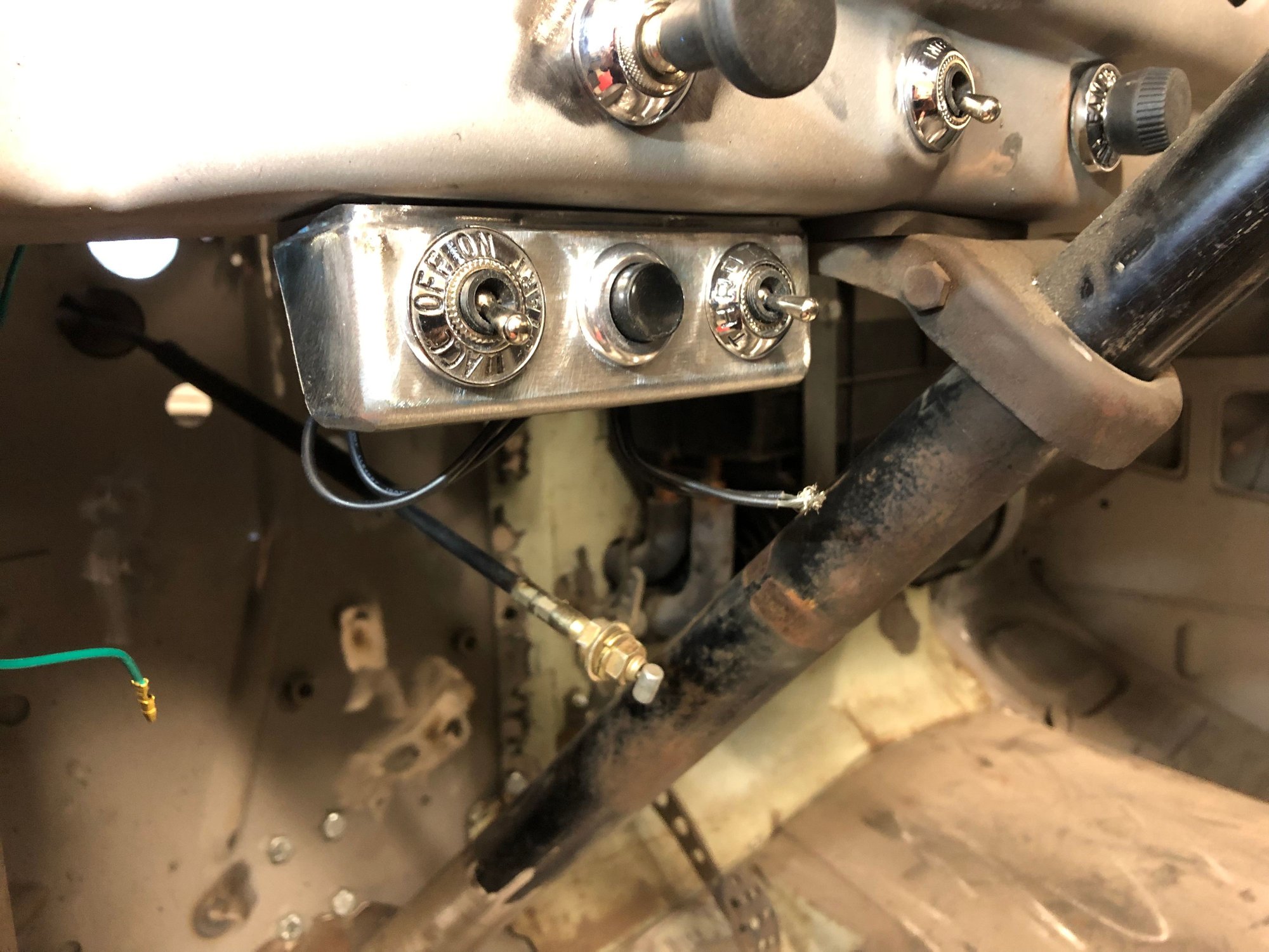

Then there is the issue that the original dash is actually pretty small when you start to count all the switches you might need! Originally this car had something like four buttons and now have to fit more than double that.
for wiper/washer I will use the early 70´s broncos switch that has both functions, saves one spot for something else. And there is the problem that my driveline is 24V and all the lights etc will be 12V and then I wanna use the original 6V gauges...what a mess!!
I decided to use 12V alternator and a change-over switch that is used in Zetor tractors. Basically you are using everything wit 12V but when you start the car the switch cuts out everything else and uses both batteries to make 24V for the starter. These where pretty expensive years ago, about 1200usd but now you can buy the for 30usd from Estonian webshop. This helps me with the original gauges that I can use with the voltage reducer 12 to 6 volts.
For extra switch-panel I wanted to make something "round edged" under the dash. I have no fabricating tools to make round corners so I bought a 4" home deposit box from local market. It has the perfect size for 3 switches and nice, round corners...cost about 10 dollars.

This came out from the ”homebank”. Easy, fast and fits the round style of the dash😊
That is brilliant and beautiful! Looks perfect!

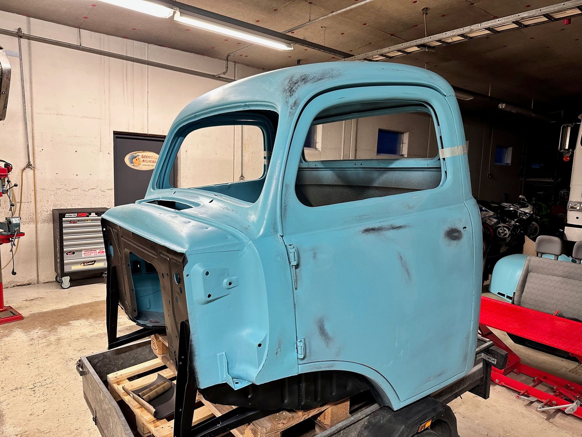

All the bodywork has been done for a while now. It has even been painted...BUT now when I`ve been looking this color, I dont like it
So we are going to change the color one more time next month. I am going to go matt red and try to sand it to look patina, not easy
I was suppose to get this done and registered this year...but noway its gonna happen!!!! Next year our DMV charges 400e (440usd) because I have changed a gasoline engine to diesel!!! This is because of the "green" thinking that is going on! If I would use electric, natural gas or ethanol no extra charges
this is going to change....red it is

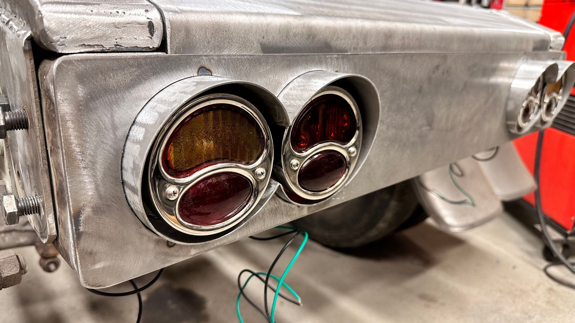

Taillight housings…cutting, drilling and welding😎
This is the latest version…hopefully last version too😂 Model A taillights👍🏻
