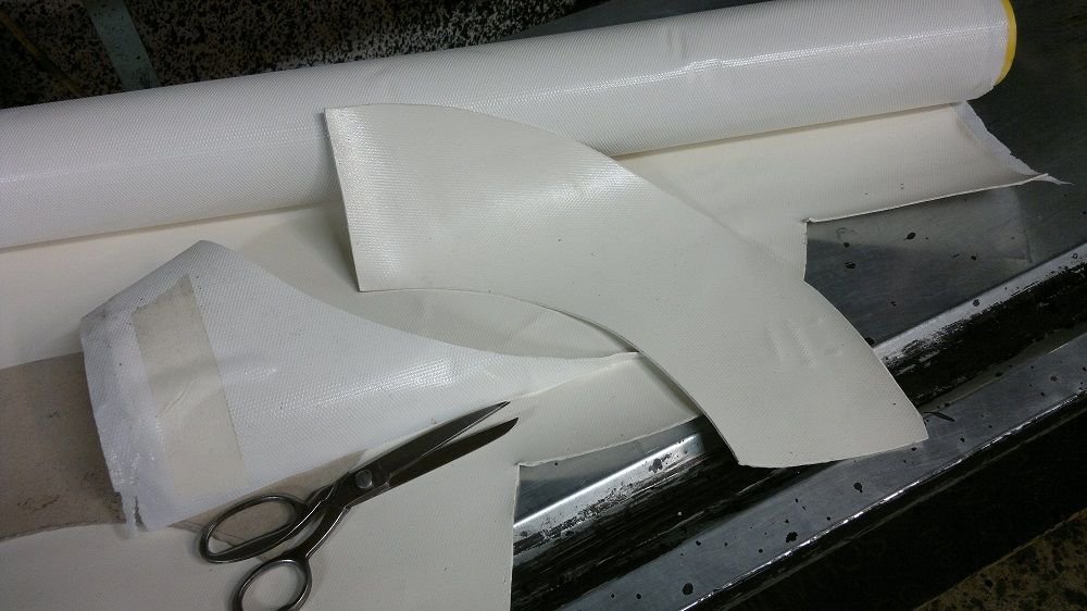

When I first saw the GM Futurliner, I knew that I had to have millionaire-whitewalls to my truck!!! The problem was that I couldnt find them anywhere!!! We have this thing called SISU (guts) here in Finland, and I thought that if you cant buy them.....make them! I concidered all the "normal" ways to do this, but allways the outcome has been quite poor: paint doesnt last or comes brown with time. And the big problem of course is the tyresize....theres no truck whitewalls out there. Well Im lucky to have good friends in right places. We where able to use a local tyreshop and their equipments.
I bought a new set of vintage looking tyres from the local company and then we started working with them. When you have to make the tyres side completely evev and flat, you realize how much there is writings, markings, stripes etc. First the tyres where grinded in this machine manually and then sanded by hand for perfect surface.
Then we had white 3mm thick rubber mat, that was cut to the right size and shape. It was glued to the side of the tyre one by one.
Then the next problem. Normally the truck tyres are resurfaced and there is plenty of vacuumbags for vulcanising. But they are for the thread, not for the tyres side. So friend of mine made a vacuumbag from a large innertube. The whitewalled tyre is in low vacuum in this picture. It has to be in a vacuumbag when it goes to vulcanising oven, or the white stuff drops in the bottom of the oven.
The finished product looked like this...we where quite please how it came out. I think this the only way how the whitewall might stay in the rubber...time will tell when I finally get this truck running....
