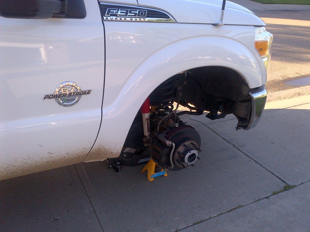

I neglected to knock on wood after voting in that thread yesterday that I didn't have problems with my truck. Whoops.

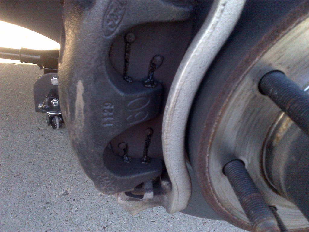

So I was driving and noted a burning smell, but then the 'Cleaning Exhaust Filter' message came on the display so I chalked it up to a regen... but then it was smelling a bit stronger in the cab than a normal regen does and the steering was pulling over to the right so I stopped and walked around to find that the front passenger side wheel was quite hot, and the glue binder stuff was bubbling and oozing out of the brake pad.
I figured I got a rock stuck in there or something, so I drove forward and stomped on the brakes hard a few times which usually gets rid of whatever is stuck there.
That seemed to solve the issue since the vehicle was no longer pulling to the right, but now I'm home and I have the wheel pulled off to check for any other damage or other debris that got stuck in there. I also checked for kinked brake lines and couldn't find any.
Do you guys think I should pull off the caliper assembly and inspect further, or just blast copious amounts of brake cleaner in there? I'm not exactly sure that would do much except evaporate since the brake/rotor is still quite warm at this point. I don't see any deep scoring on the rotor, but the colour did change due to the high temperatures it experienced.

Check the caliper slides. I would loosen the bolts holding the caliper to the slides and make sure you can easily move both slide pins with ease by hand.

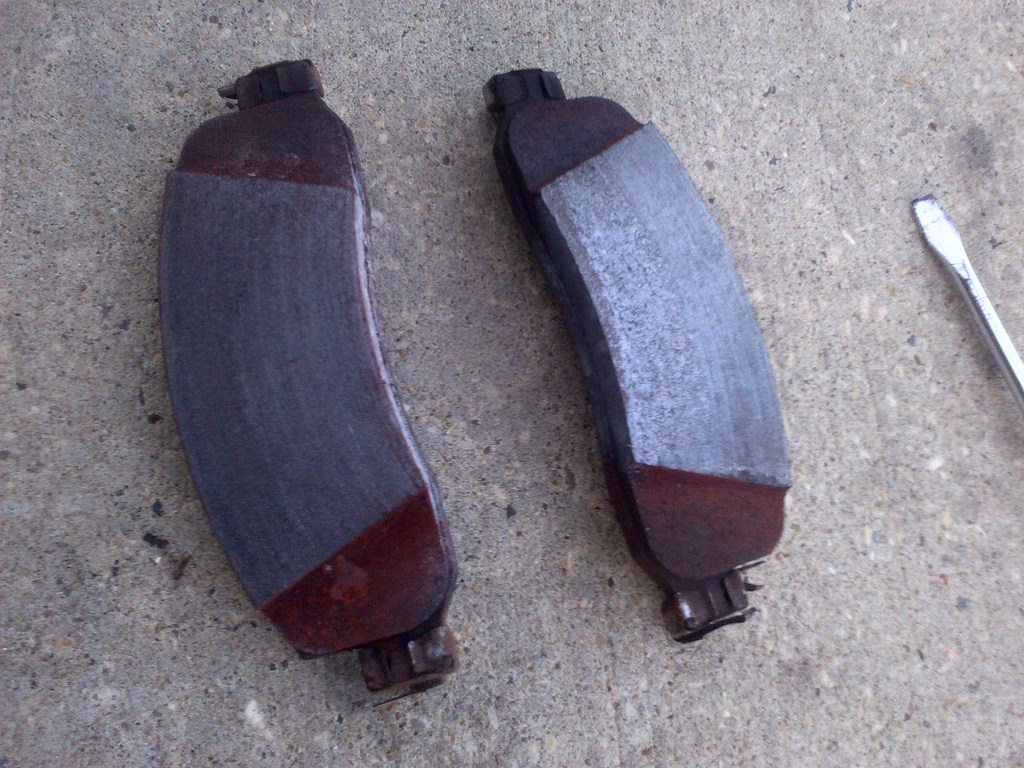

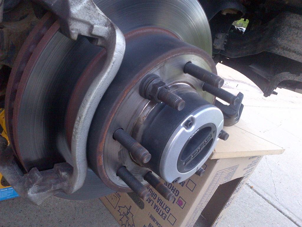

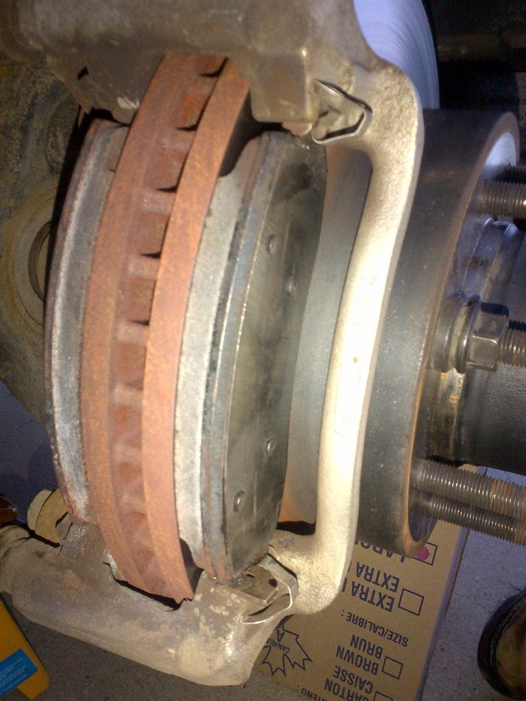

I took everything apart, cleaned off the glue mess and the metal scale with a wire brush and a lot of brake cleaner in a can. Then I went out for a drive on a freshly paved road, shifted to neutral, shut off the engine and coasted the rest of the way to see if it was still dragging or making weird noises or burning up again, which it didn't, so good enough for now.

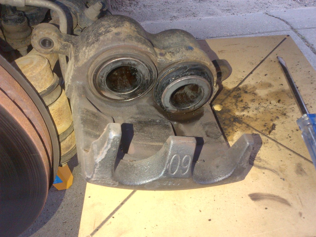

Those caliper pistons are not looking too healthy though...
Brake pads still have material so I didn't burn it all up.

did you grease the slide pins as well? that is what is sounds like. both pads seems to have (in the pic to me) about even wear so that is a good thing.

I last greased the slide pins at around 12,000km but not the pistons themselves. I'd probably lose some brake fluid doing that. The rubber boots on both caliper pistons are all messed up because of the high temperatures. The boot doesn't hold the brake fluid in but the seal behind it does, and apparently the seal is made out of the same material as the boot/dust cover.
If the boot melted due to high temps, then there's a chance the seal could also be compromised, but I'm not noticing losing any fluid loss yet.
Hopefully one of the dealers will do those steps when they check it, I feel the caliper assembly should be a warrantable item because it's not a wear item, while the brake pads and rotors are. I'd be fine for paying for the brake pads if it comes down to that, but those aren't really worn down either (and if it was normal wear it would be on all wheels, not just one).

Waiting on a caliper assembly to be ordered from the USA... no one knows an ETA so sometime between now and forever I should be getting a replacement.
When (if) this part shows up, it will be replaced under warranty, but for now, it hasn't been acting up.
