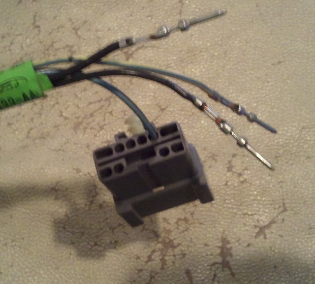

So... I took apart the connector on the end of the cruise control connector and forgot to take a picture of it...
Can someone shoot a picture of the back steering wheel side of the cruise control connecter under the dash...

Here you go, hope it's the right connector.
Not easy position to get into for the picture and hope it's OK.

That helps a lot... and you zoom out a bit to get the wire colors on both sides? I can kinda see one in the lower right...

Let me go look and see if I can determine actual wire colors with a flashlight ...

On mine ...
Top Right - Blue with Yellow stripe
Bottom Right - Black - Larger wire
Middle - Blue with red stripe
Left - Black - Smaller wire
Can't see any stripe markings on the black wires.
