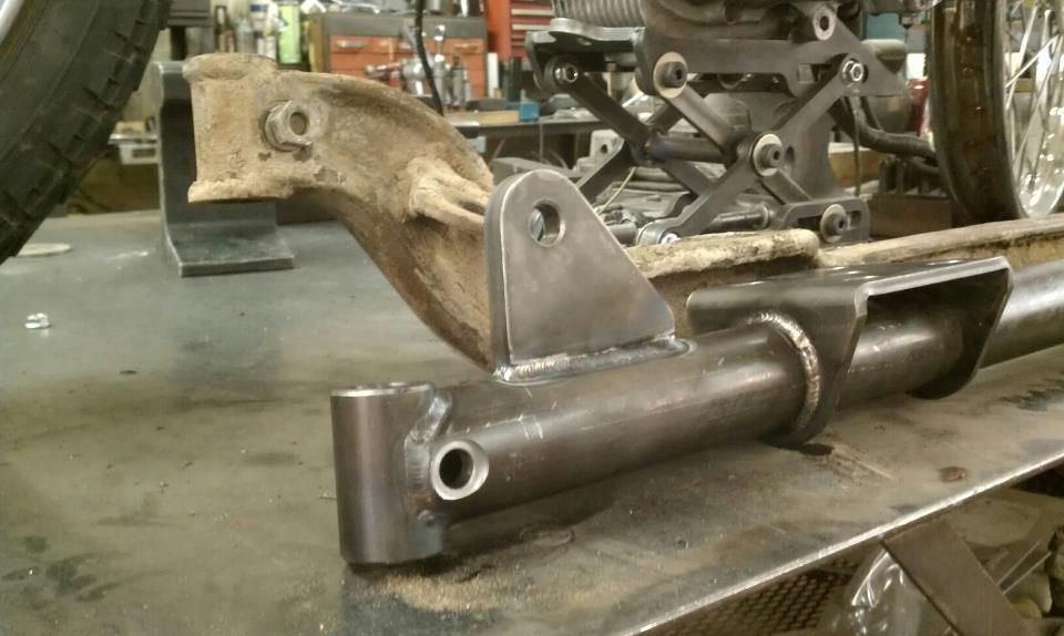

Thickness has nothing to do with it, The formed boxed section provides the strength along with forged fitments inside the rails.
Wonder what is inside the CV rail? Apparently you have zero clue. Pics by rusty 63.
You keep insisting on spreading the fallacy that this suspension swap is safe and easy.

Yes I have no clue whatsoever since I cut the chassis apart on the CV that donated my IFS. My guess is you cried it won't work when people used Corvair swaps, MII swaps, the original Dakota swaps (the only 1 you seem to think is a reasonable choice), Aerostar swaps, Volare swaps & every clip job out there.
Dents, bumps, slicks, fridges & the '53-'56 body trucks are all using it now. How many have you seen say it has failed? How many broken crossmembers? I haven't even read a thread yet about a truck that has been wrecked with 1 in it regardless of fault.
My truck is doing just fine along with many others that have big block engines. The only person crying it won't work is you with no evidence whatsoever.

elgemcdlf;This is an early CV. Even at that the piece you show is only for attaching the rear mount to. Same as nuts on the ends of bolts. Nothing more than sandwiching the rail between this piece and the mounts. The later CVs have welded nuts on a different bracket welded to the bottom of the CV frame. You will also not I have always recommended boxing the chassis. There are simply way too many trucks with this swap that are doing just fine. I have yet to read a single source stating it has failed.
It is an 2004 Chassis.
Boxing may not be sufficient or up to the home builders skill level.

YOU SHOULD SEE THE NEW STRAIGHT AXLE I HAD MADE!. It is total FRACKIN bad *** monkey spanking straight axle love!
My 69 Crew has been doing fine with 6" factory lift blocks since ford built it.
The 4" Lowering blocks on the 64 rat rod is for adjustment once the truck is finished to set final ride height, IE they get shorter to level the truck once all weight including the driver is on board. You may want to read the entire thread as this is a back in the day use. The Owner set the parameters of the build.
I guess you missed the de-arched and reversed eye springs and the dropped front axle in your zeal? The truck is a theme build with the use of parts and methods available to a backyard builder that would have been avalible in 64 for a build. yes reverse eye and de arch is old school... Aeric would have been really pissed if i put an IFS in it. (well the dual master and prop were a compromise i insisted on, However it is a corvette looking type and would have been used back then.)
Here is a picture just in case to save you apoplexy looking for it.
And lookie just how low a straight axle can go. Lets see your CV get this low without bags.
And here is how low a IFS can go. Lets see your CV get this low with out bags. Oh yea i can go another 2 inches with drop spindles that are amazingly produced for Dakotas. Find some dropped spindles for a CV other than ones custom fabricated and one off.
Another build of mine. And that pesky crew cab with 6 inch rear lift blocks.
