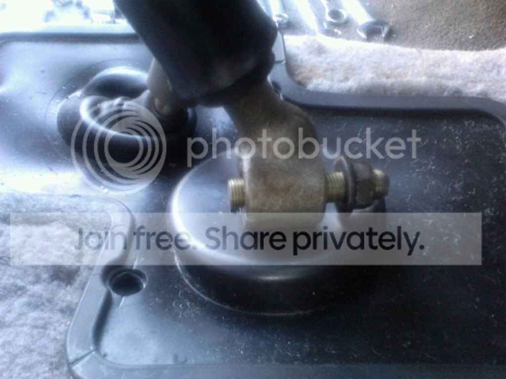

Got me a Chilton's manual. Just getting started on the job. The gearshift and 4x4 lever are giving me a little trouble. I got the ***** off OK, but the book said to remove "the bolt" and remove the lever. I haven't been able to find "the bolt" yet....

Its a reverse bolt, take the nut off the bolt put it on the other side and tap with a mallet. It will push out.
do as Hank said swap the bolt and to tighten it up it will pop lose.....it is a wedge.........................

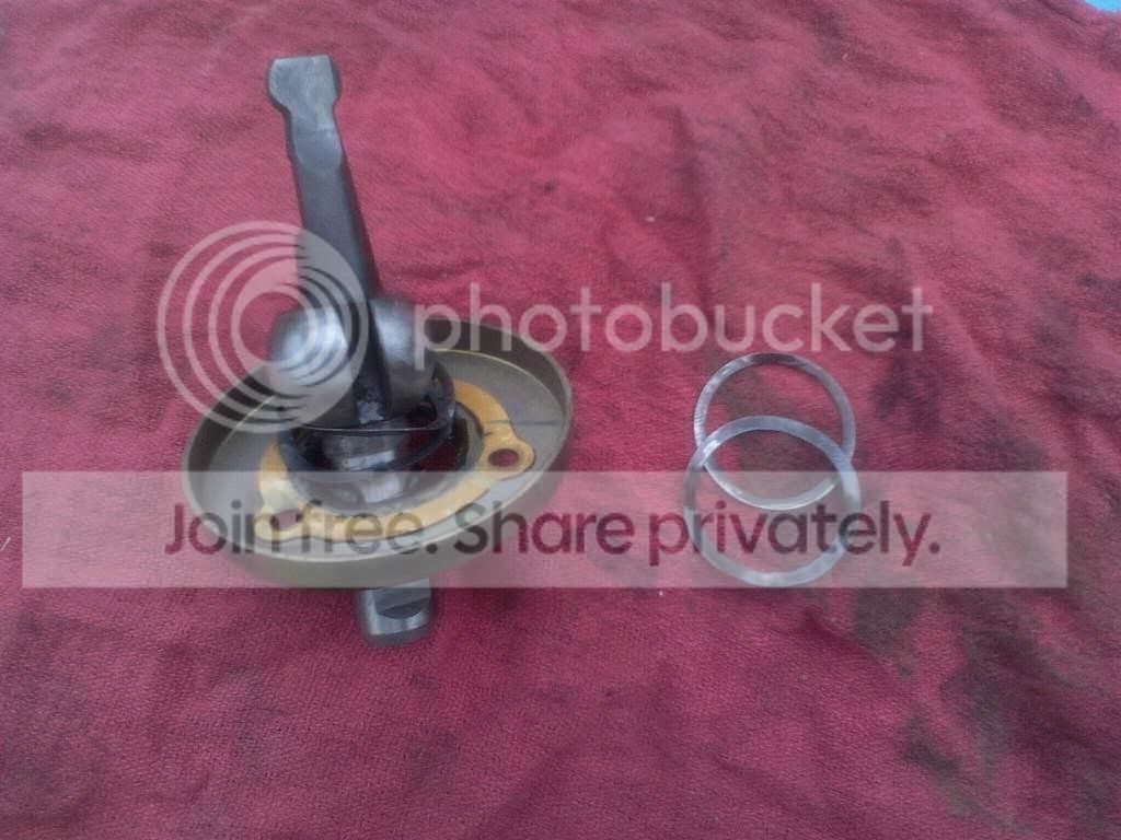

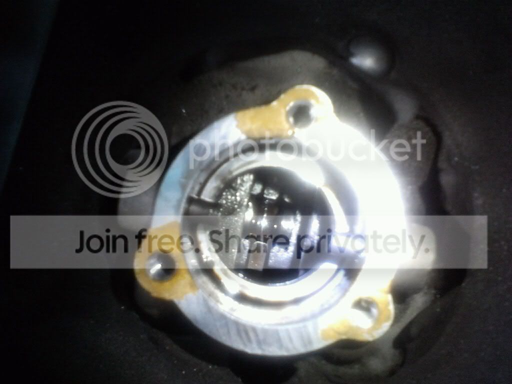

OK, here we go. I made sure the transmission was in neutral, then i removed the three Torx bolts and removed the shifter from the top of the transmission. I really don't know what this stuff is supposed to look like, so I am not sure if there is a problem or not. The shifter rod cam out with the retainer, a seal where the shaft passes through the retainer, a couple rings between the ball on the shaft and the retainer, and a couple more rings were left in the counterbore where the shaft came out of the transmission. Here are a couple pictures to illustrate:
Thanks for the help!!!!
sorry but I can't tel from the 2nd pic if they are lined up correctly..you could play with it a little by putting it back in and put it in a gear then remove it.see what the levers do........I do know that can have a hard time putting it back in properly unless it is in neutral......you can use a big screwdriver to move the levers around.

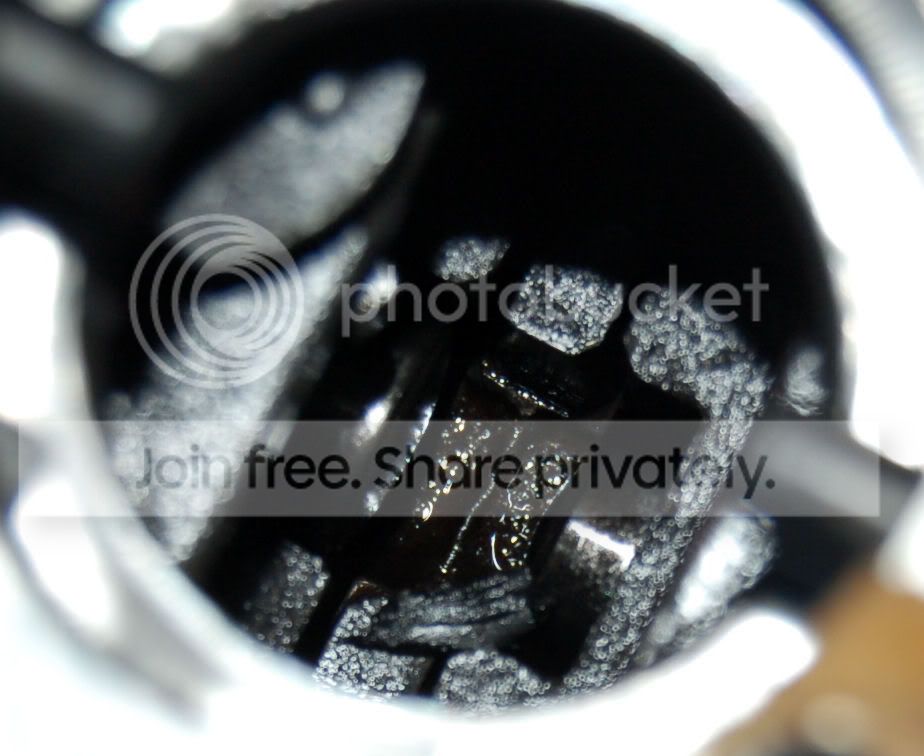

Here's a better picture:
I used my Nikon instead of my phone!
I don't really see anything that indicates the catastrophic event my son described to me. I'm going to start looking elsewhere. Drive shafts, transfer case and transmission are next. Been trying to avoid dismantling the entire drivetrain, but it may be about time to bite the bullet.
