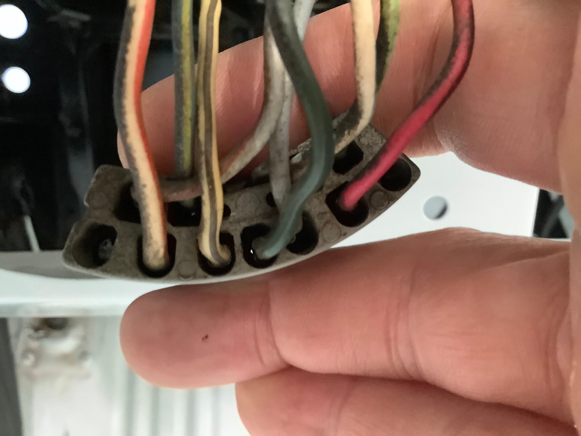

Steering colum question
I am trying to identify this steering colum. Supposedly from a 75 Bronco. I think 78 possibly

Well that 1st pic is an early 66-77 Bronco for sure. The steering column (shaft) in my 71 looks original (but not 100% confirmed), and it does NOT have the slip shaft set up, that compresses if in an front end collision.
I have the flex (rag) joint right on the splined part coming out the fire wall and the u joint connects to the input shaft on the steering box. The FTE EB site has some traffic, but this site is chock full of EB gurus. https://classicbroncos.com/forums/index.php

Looks like a 76-77. 3/4 inch outlet. Must be from a manual steering bronco
