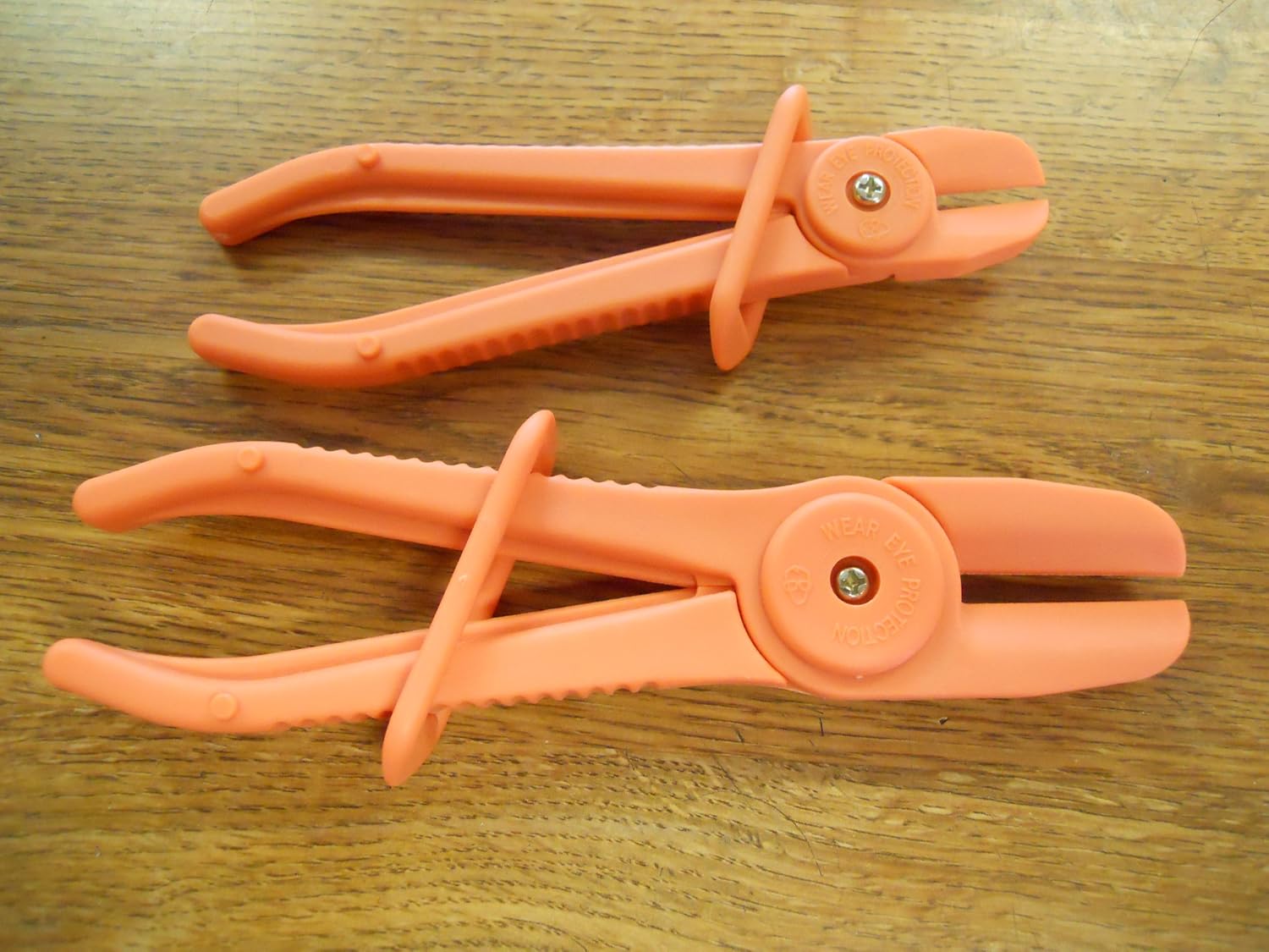

I know I'm going to go to da store and buy a bunch of new hose and replace all of the lines for better routing, and to get a bit more coolant in there.
Then I'ma put a shutoff in there for it as well, cause I loose way to much coolant pulling the filter. I hate cleaning it up.
Save yourself the potential location for another leak and get yourself a set of these:
They're cheap and work really well for this kind of thing!
Amazon.com: Craftsman Hose Clamp Plier Set: Kitchen & Dining
Do they damage the hose after much use?
I dont susspect they would
They are plastic, so they are not going to crimp the pipe unless you clamp them too hard.
Really neat tool!
