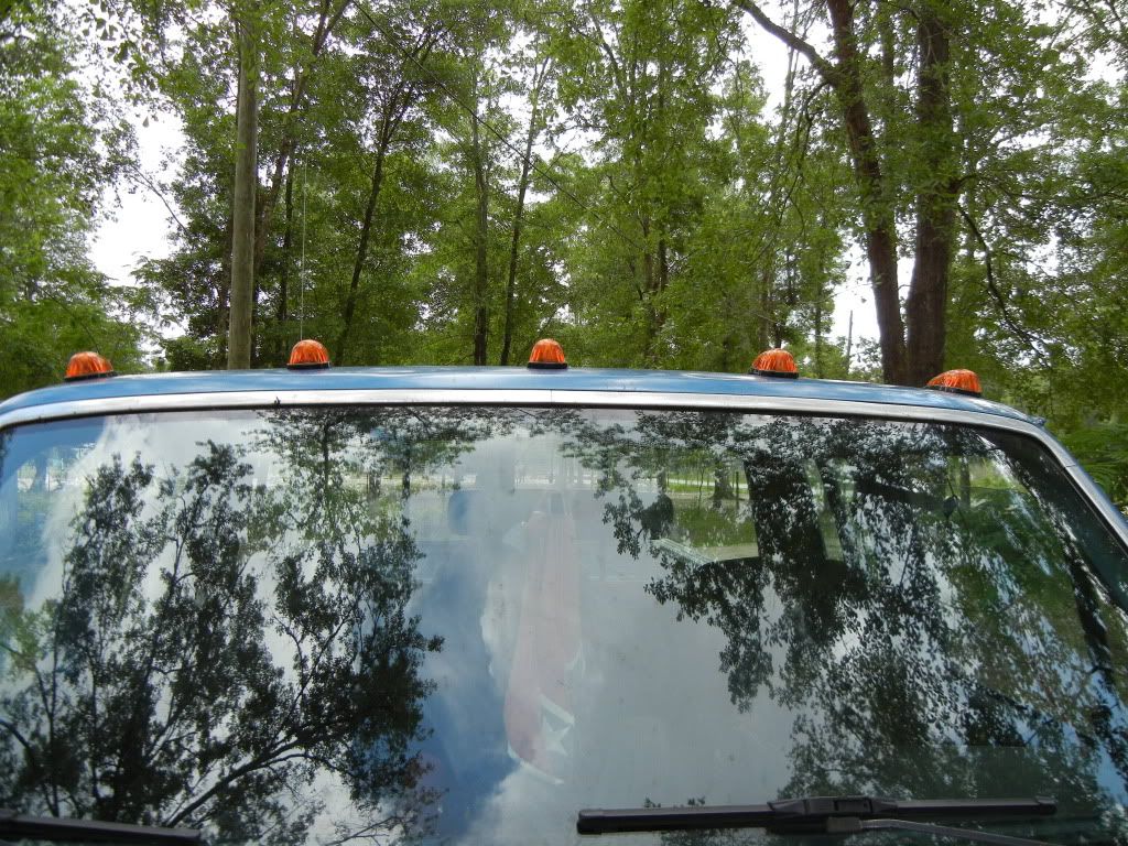

finally had time to put my lights on my truck. thanks for everyone's help

Old May 23, 2012 | 04:28 PM
GNR22's Avatar
GNR22
Joined: Mar 2011
Posts: 4,197
Likes: 558
From: Central Wisconsin
Sharp looking truck, man. Turned out really good.
Old May 23, 2012 | 06:30 PM
ncranchero's Avatar
ncranchero
Joined: May 2003
Posts: 3,310
Likes: 9
From: E.Lincoln County, NC
I like the nutserts and grommets nice job !!
