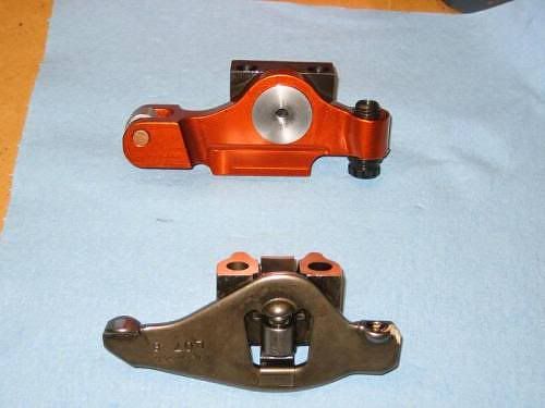

Originally Posted by cookie88
That is true.. They are cheap and easy. Probably why they are built so weak. A real roller rocker with a different, or even adjustable, ratio could alleviate that problem.... Of course, there would be no room to mount them and still clear the glow plugs.
Whats stiffer than the 910's?
Something like this???? Pictures courtesy of Jason Hoffman.
Adjustable roller rockers are available through Wipe Out Enterprises for us. From what I understand, part of the assembly is built by Harland Sharp and Wipe Out finishes them up to work for us. Probably not really practical for a daily driver since they probably need to have lash adjusted more often than most would really want to deal with on a DD and they are pricey. Coming in around $1400-1600 IIRC, but come with chromoly pushrods
