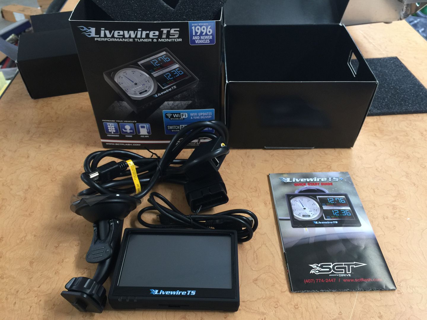

And of course a SCT Live Wire tuner

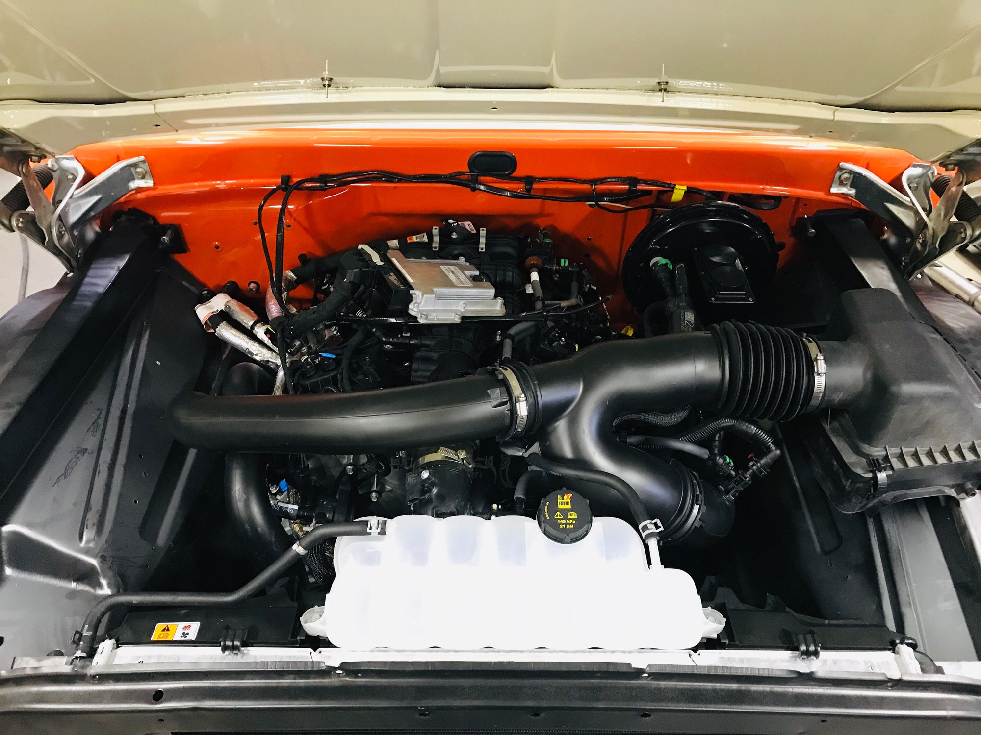

Now on EcoBoost swap #5!
decided to step it up on this one!
1966 F100 custom cab short bed.

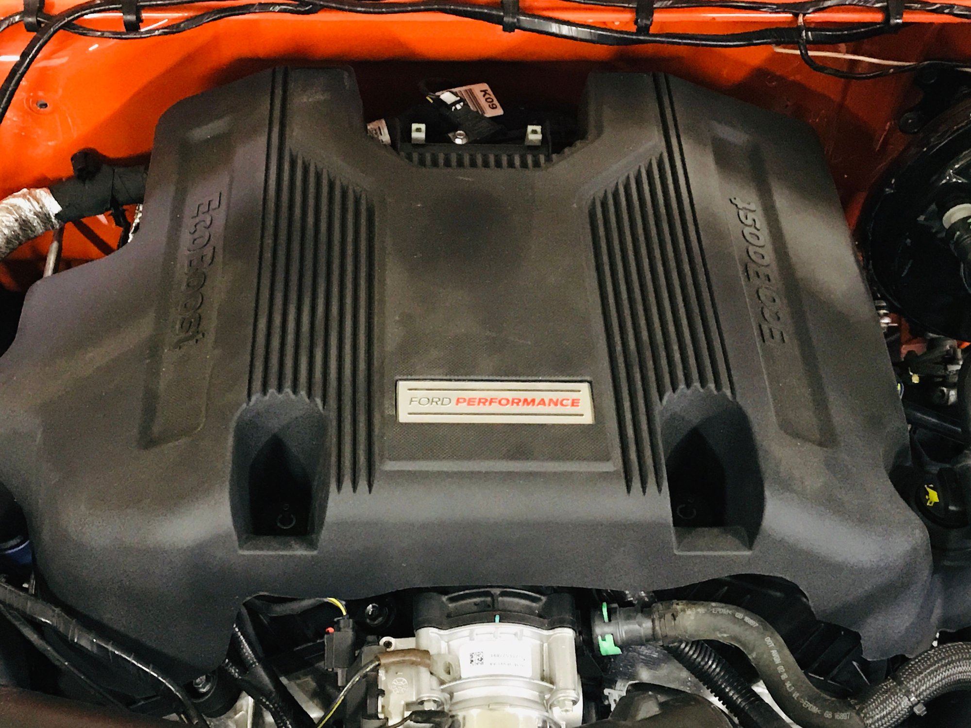

my dream truck a 40+ yr wait to drop in a dual quad 427 FE. That route for 1300 mi then after spending total wasting 5k trying to get it to run proper with the fitech EFI I sold the FE & bought a 1 of only 5 3.5 450/510 crate engines sold by Ford Performance!
Of course it needs to be mated to the new 10R80 10 speed.
truck being around 3700 lbs should run well especially with a proper tune on E50.
if interest will continue to post until on road.

Shooting for 550 rwhp on E50

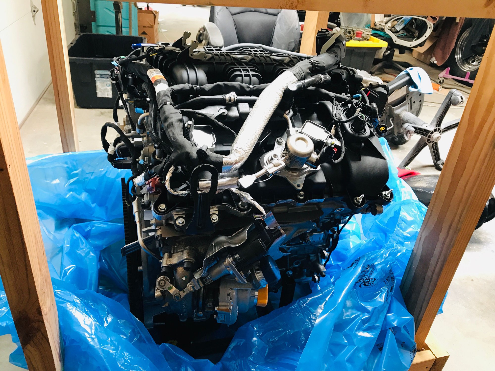

S

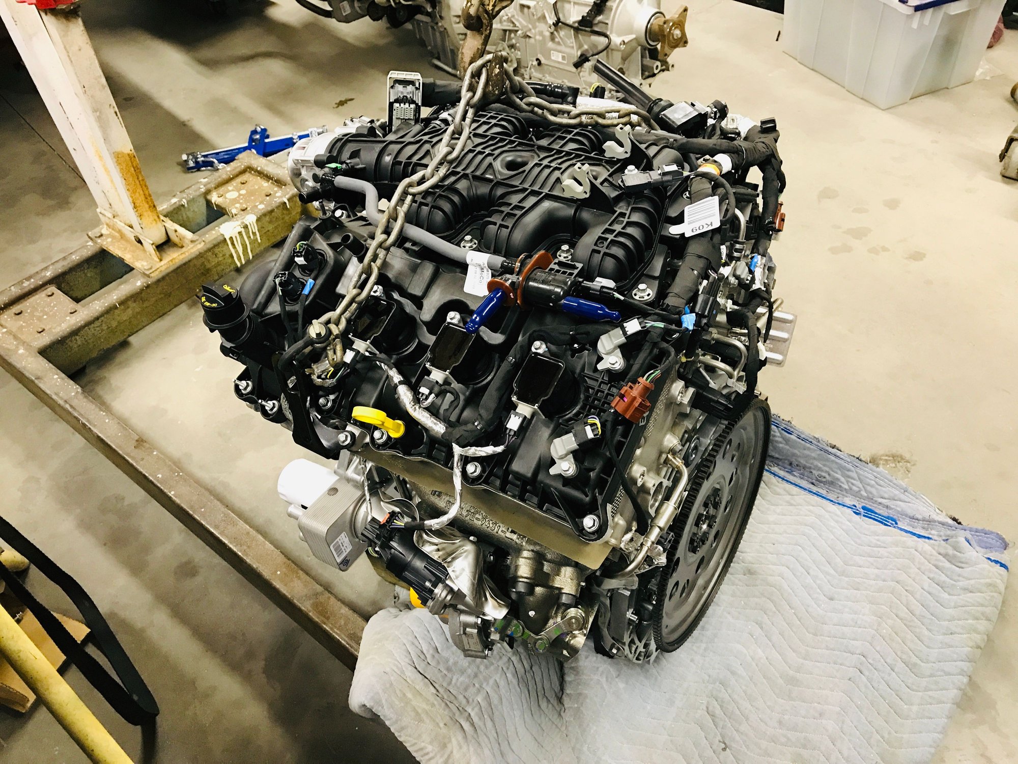

started off with #4 of only 5 450/510 crate engines sold by Ford Performance.
stay tuned for more!
this will show how easy it really is to do it with basic hand tools using stock PCM.

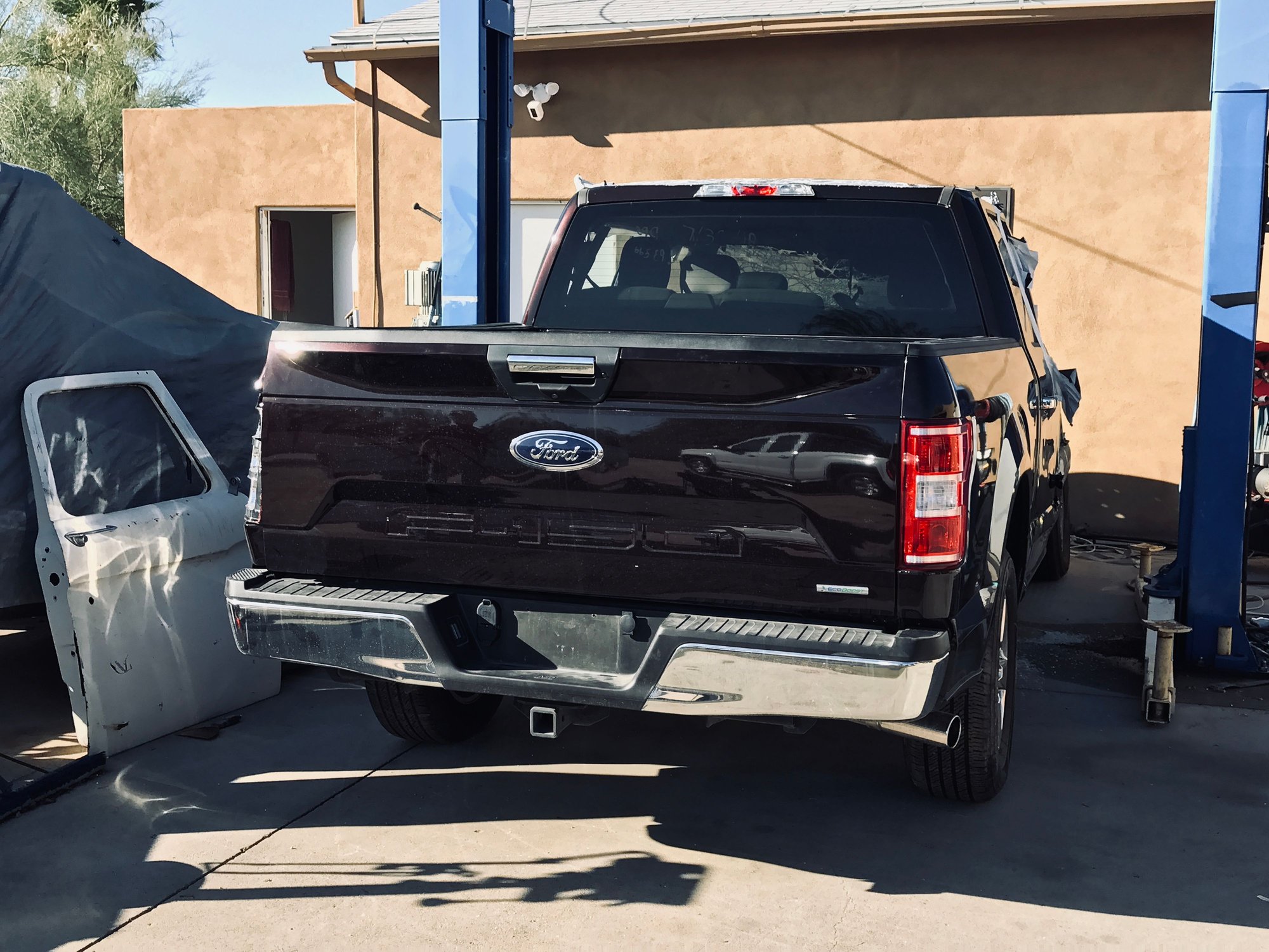

Raptor Crate engine swap.

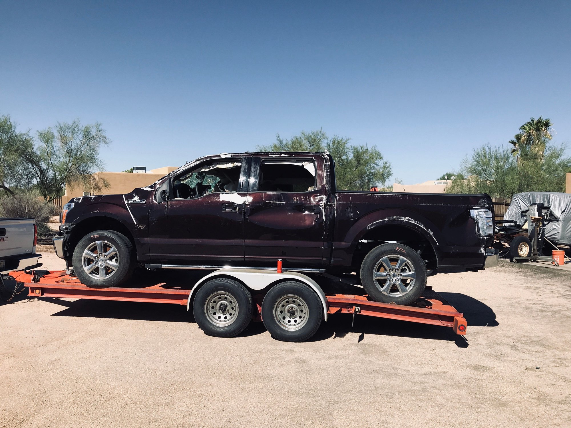

Next up was to buy a donor truck!
it was showing only 27 miles! Appears it may have been crashed on initial test drive by dealer upon predelivery test drive!
hit a parked car @ approx 70 mph.
it flipped and slid a long way in side and roof.
I bought complete truck for 3250 @ auction!
2018 F150 XLT that was loaded.
truck had sat on dealer lot over a year before being sold

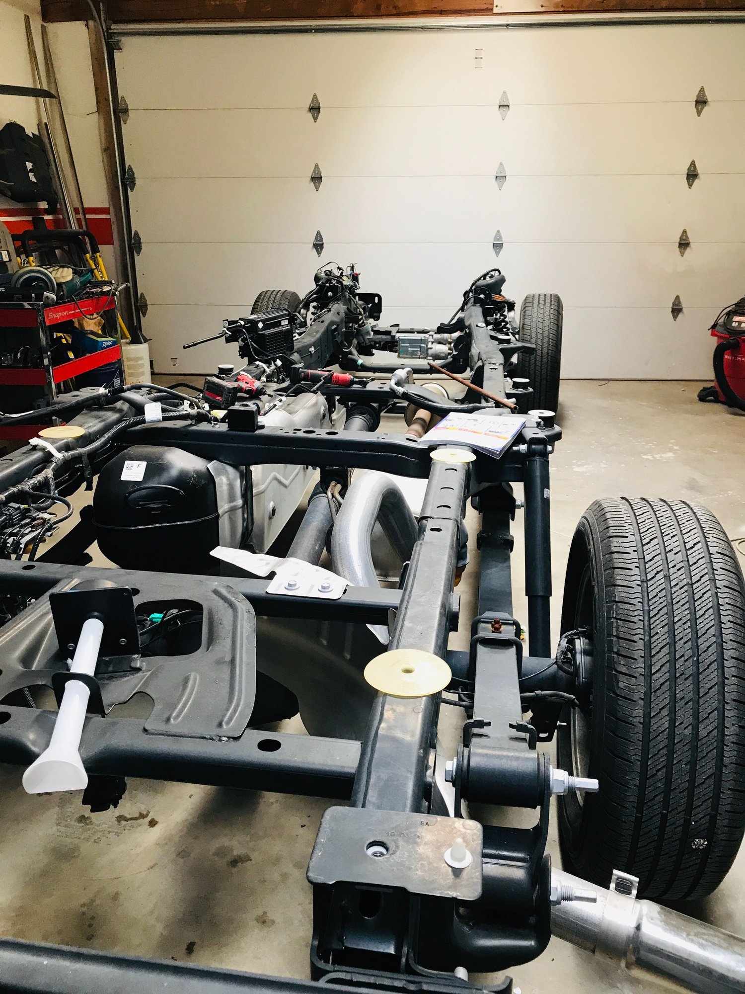

Here is donor chassis ready for another project along with the non Raptor 3.5.
huge plans revealed at later date.

Ready to run with oil and harness the 3.5 was only 404 lbs!

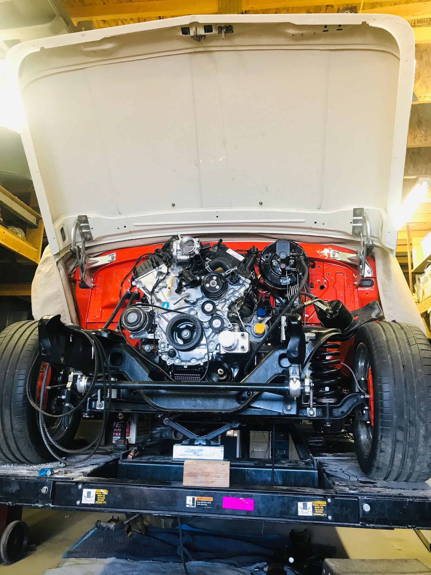

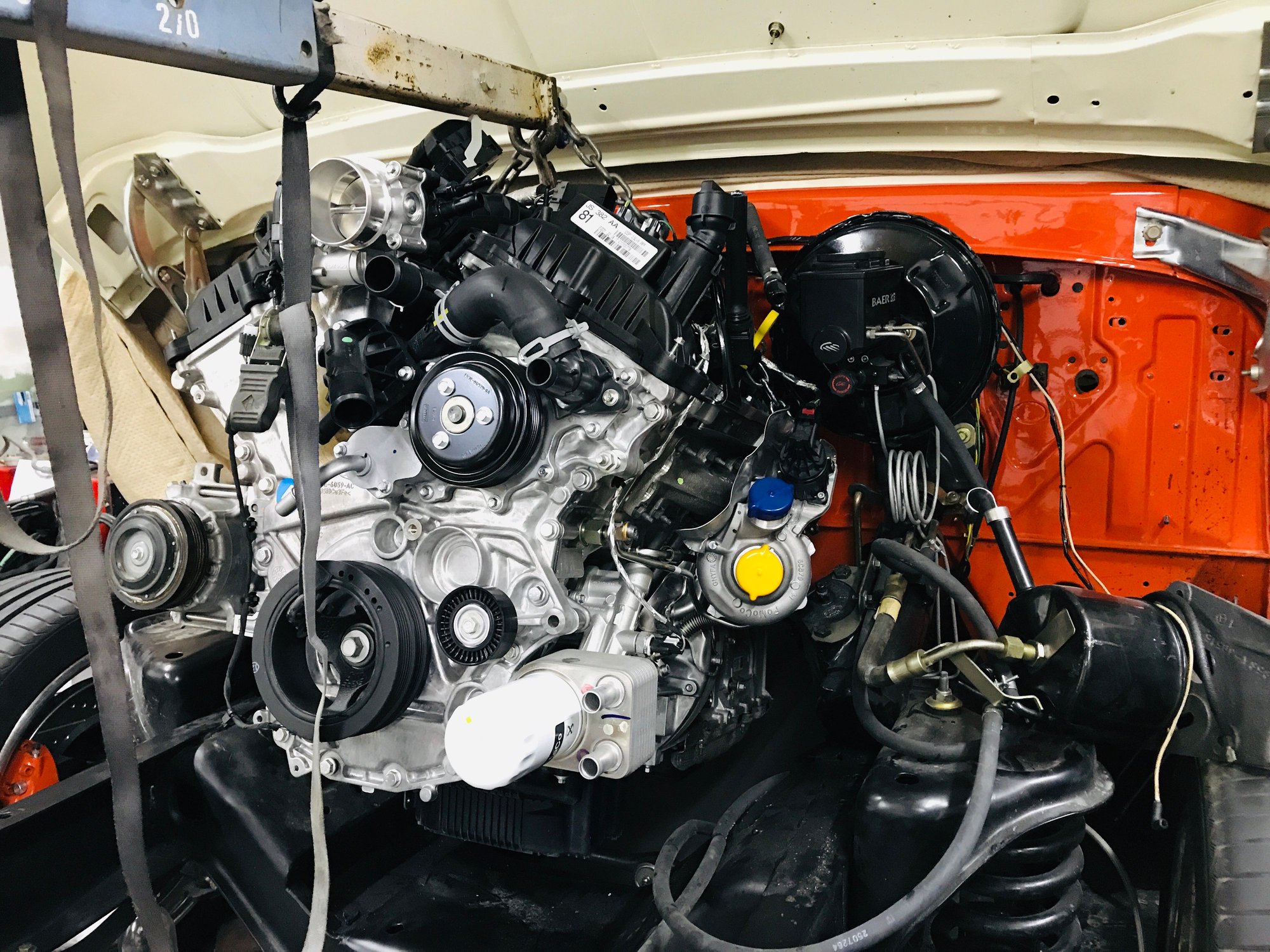

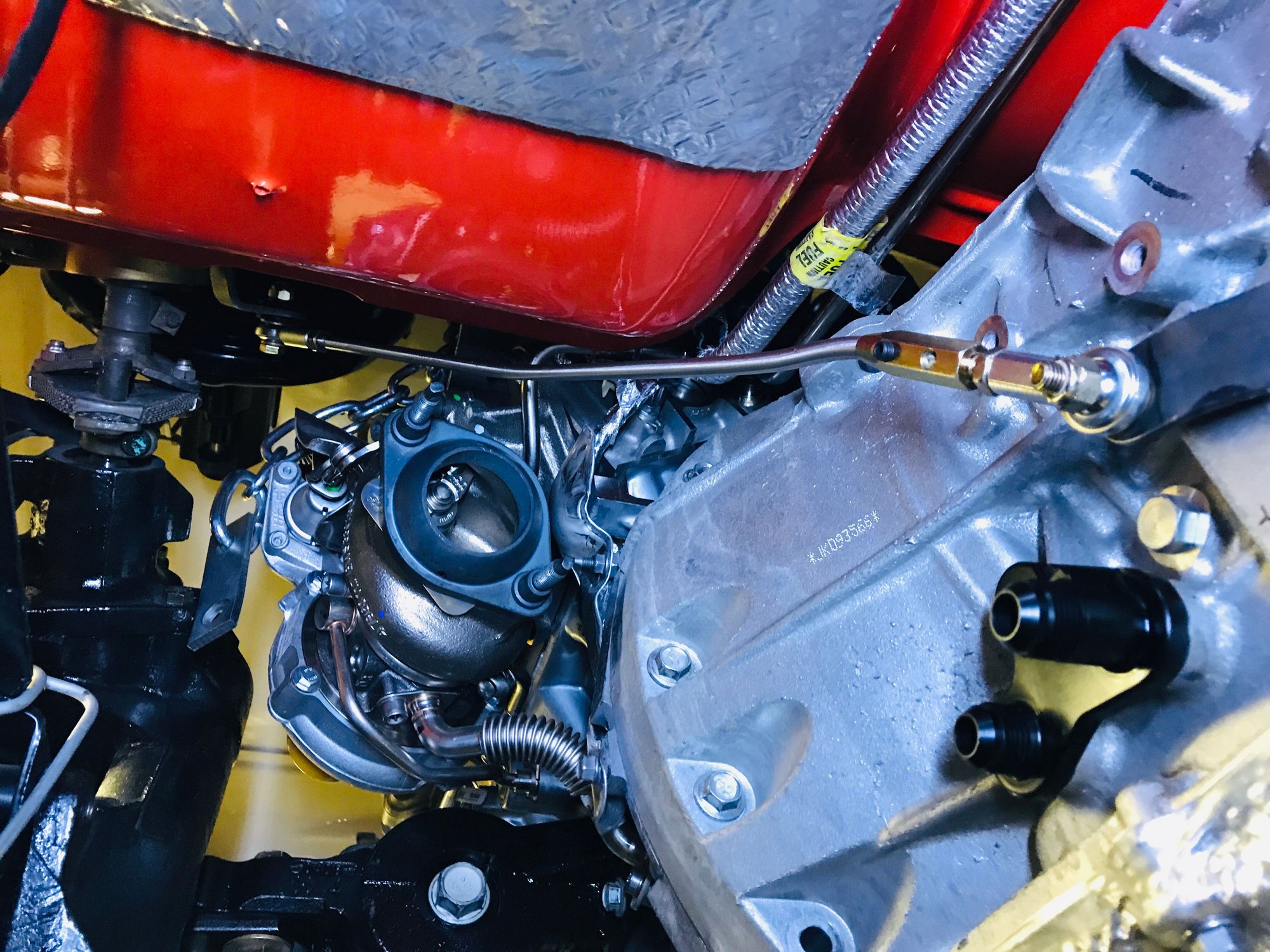

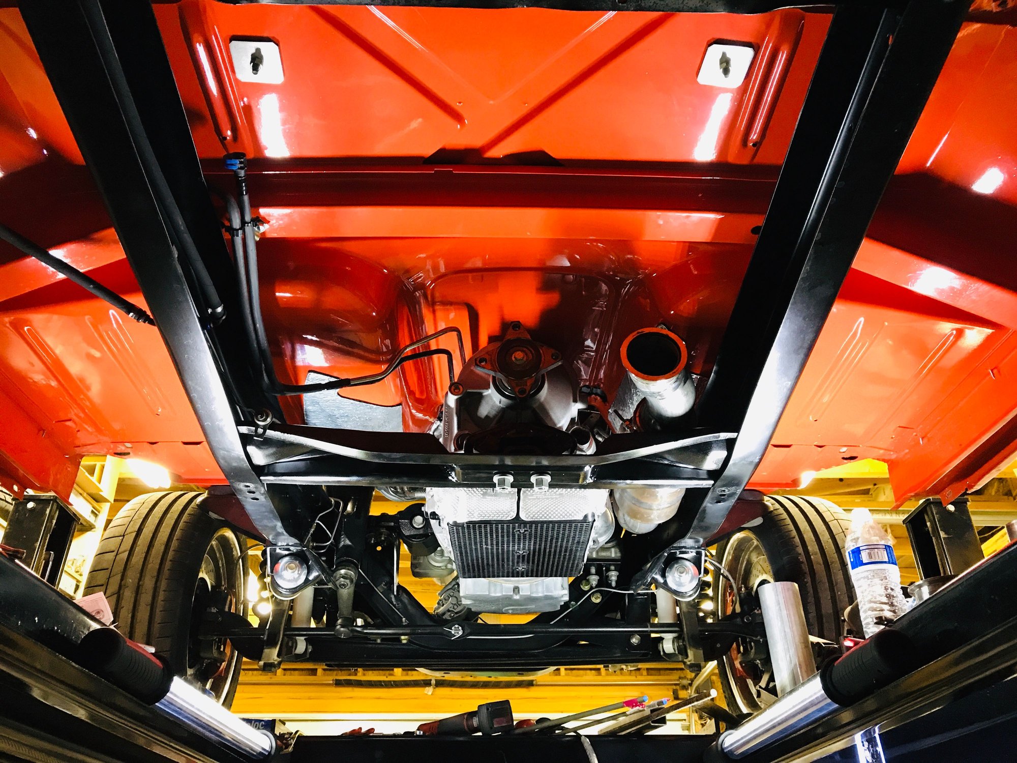

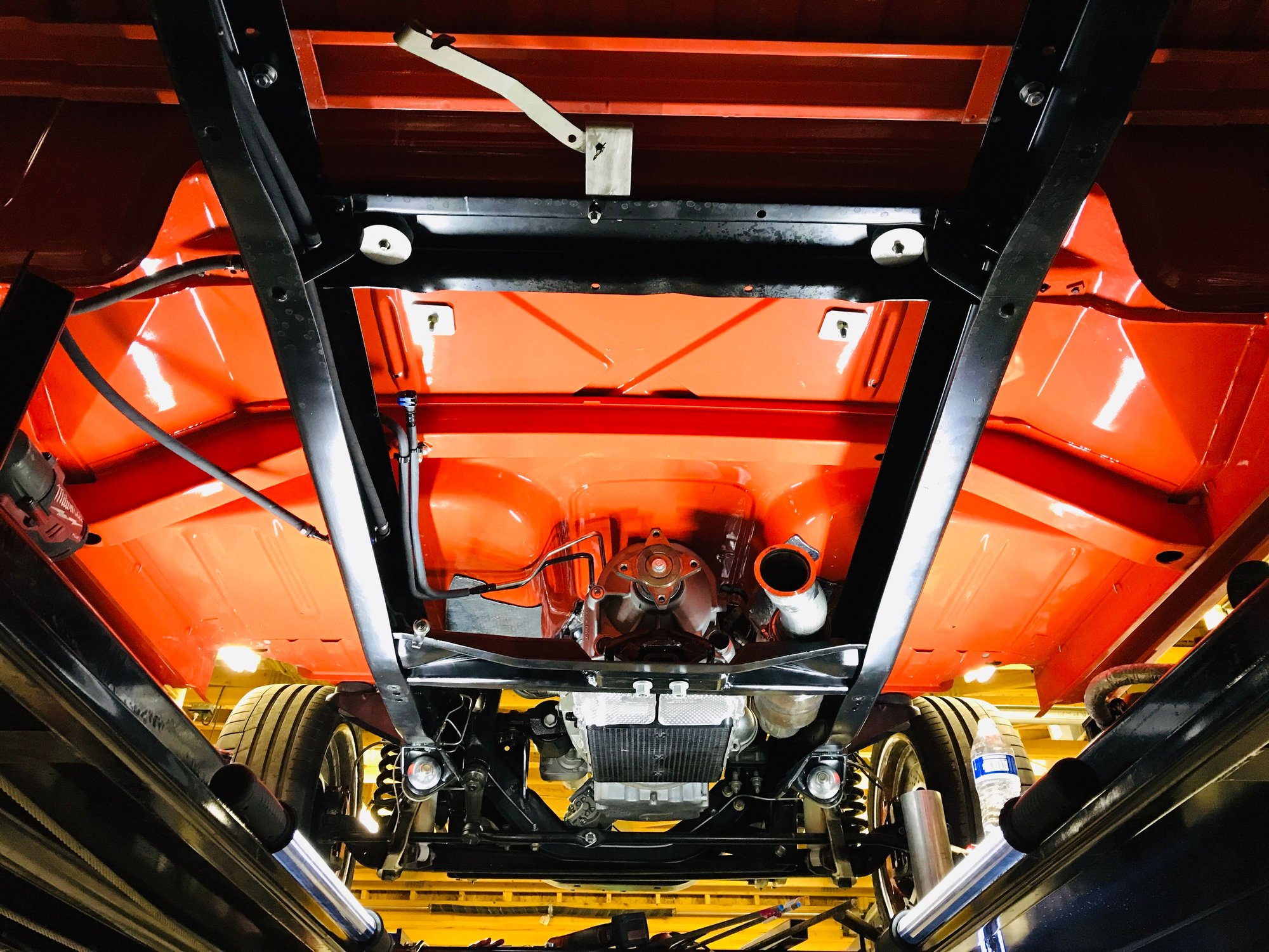

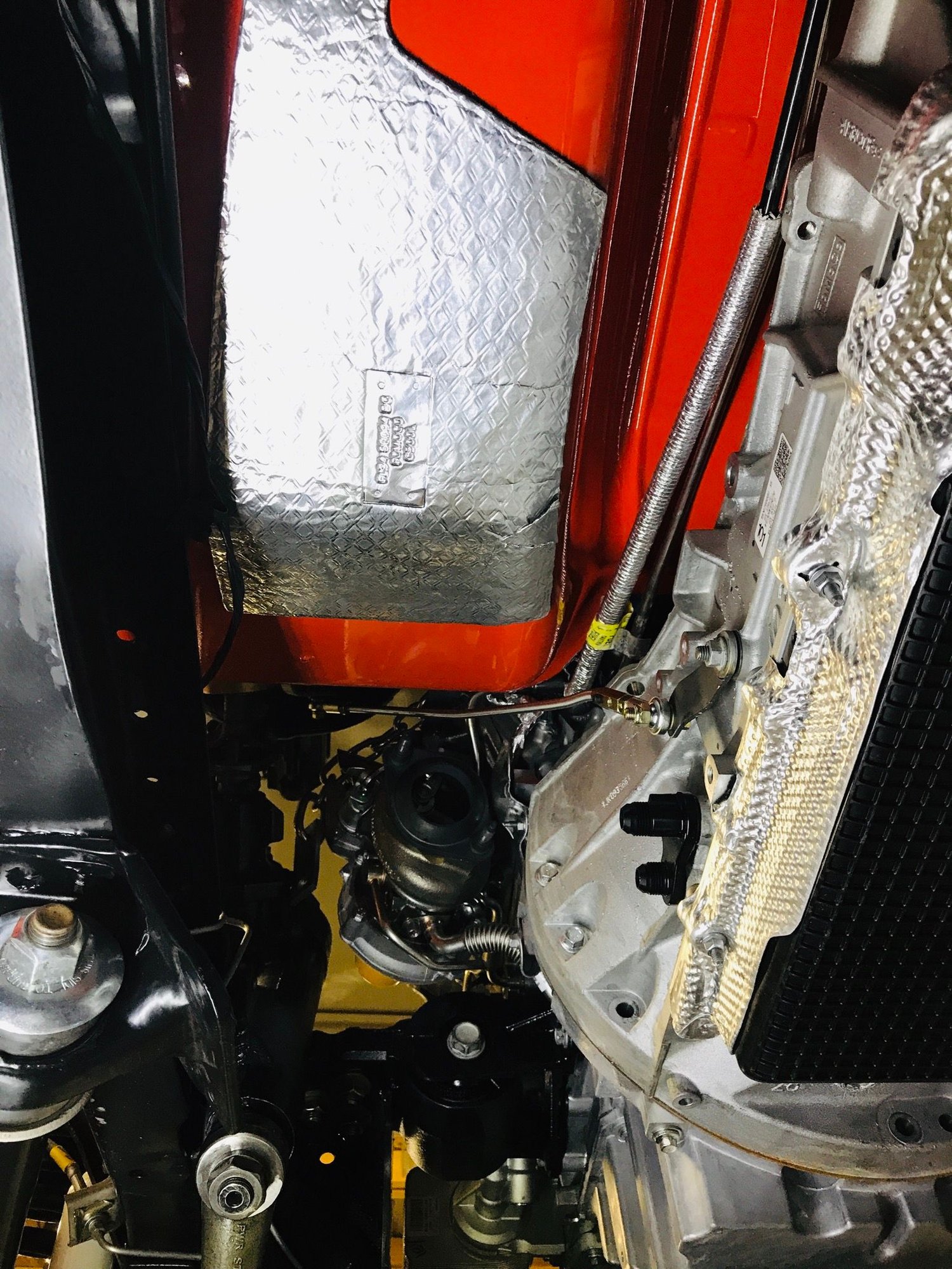

3.5 10R80 pretty much a bolt in using stock F150 mounts for engine and slightly modified F150 transmission mount! Tricky part was getting the 1966 column mechanical shift rod to work with the cable shifted 10R80.

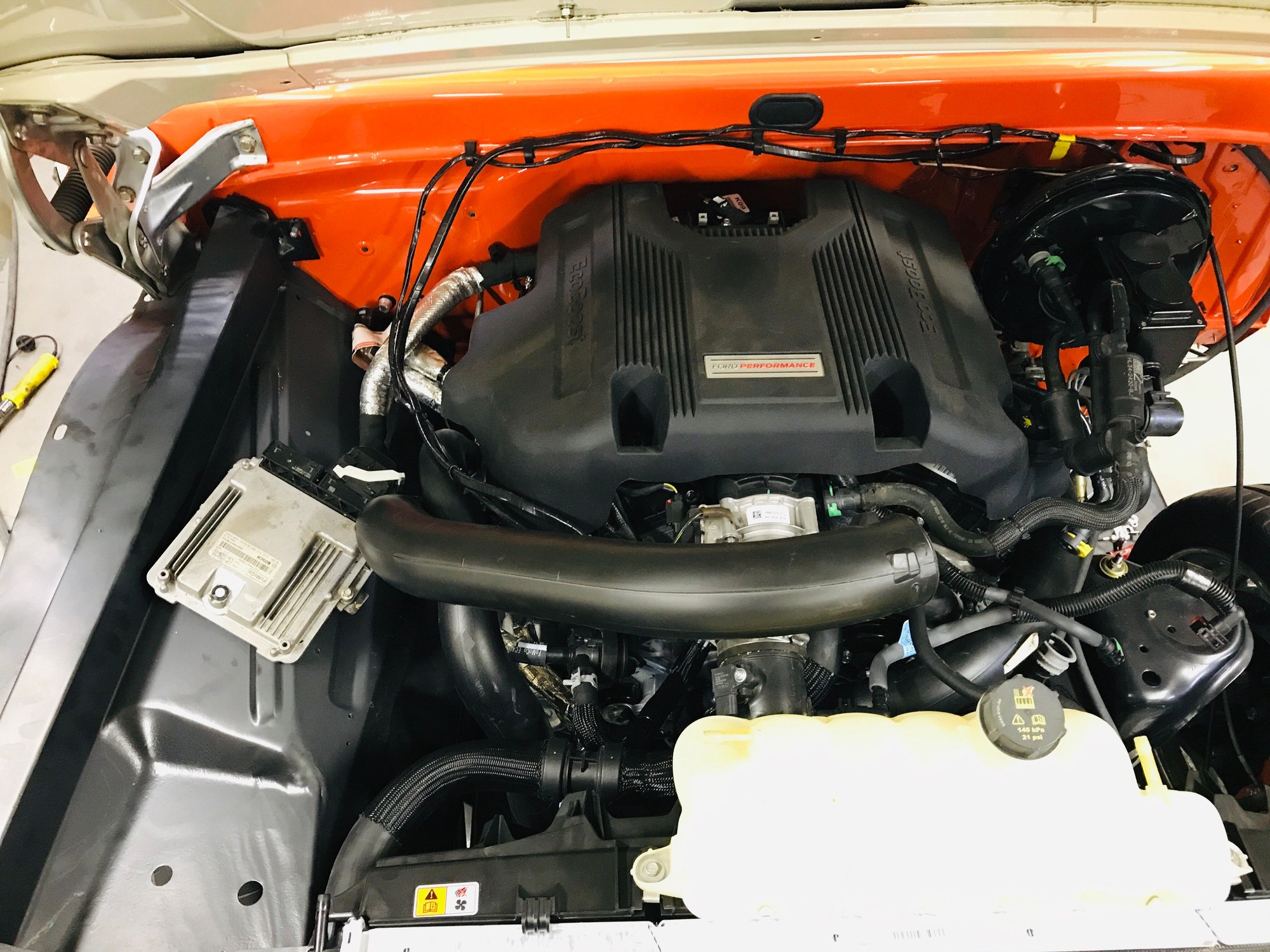

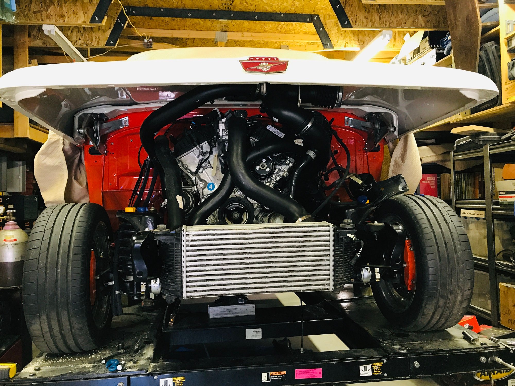

Managed to fit new 2018-20 Raptor Radiator, condenser & fans onto ‘66 core support. Intercooler fitted too! Pushing hard to see if I can have it driving within 30 days.
