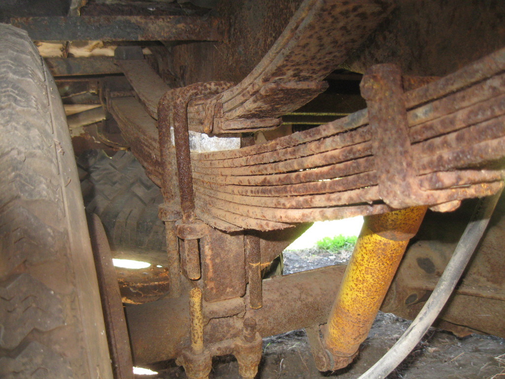

you said about the rear leafs on yours being stiff this is mine ill be tackling this week just shows how rusted this thing is rear leafs with cinder block in between the overlload leafs and one spring pack is completely snapped

ha ha thats funny thats exactly what mine look like... and you said your doing sd in the rear right? i thought about doing that as well but still kicking it around. the 86 to 93 dodge trucks are almost the exact same as the rears on the 72 f 350. there the same eye to eye. and eye to pin is almost perfect, there a quarter inch wider so about two and a half, but i think there going to work. that way i can leave the hangers alone and just run dodge spring. they will be plenty tuff enough and ill have air bags in the any way. just a thought i figured ide throw it out there. got my fronts today and set them on there. i think there gonna work great.
