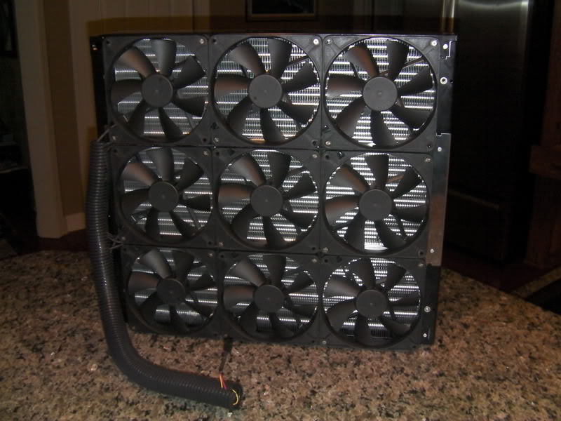

From: Stevens Point, WI

The battery itself takes load from the fans but yeah the alternator has to work harder with the efans vs mechanical. There is no such thing as a free lunch.
Now thats some ricer **** right there.

he's missing a spot!!! wowzers

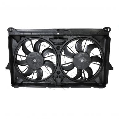

These are the cadillac escalade fans I was talking about. They are big but I think 4 could fit the diesel radiator. Also if all 4 don't fit on one side a guy could put the two big ones on the back to pull air and two smaller pushers on the front. The pushers would be right on the AC condenser I believe so I would wire those to come on with the AC.
Oops, forgot the pics. lol

Also if electric fans (can be enough for the diesel) it would be a great fix for those with the early 7.3 that have problems with belt slip when pulling up grades.
