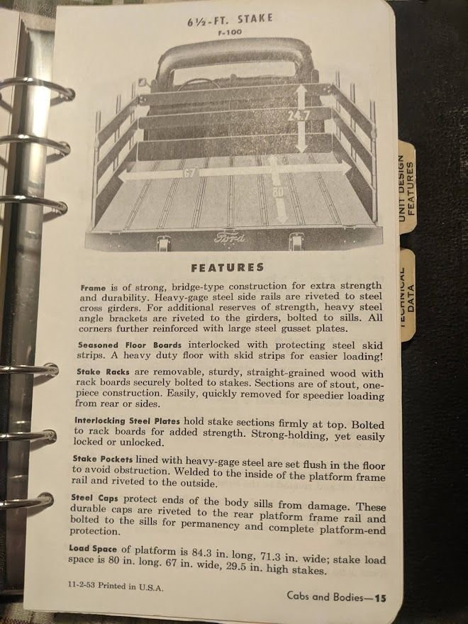

Didn't F100 flatbeds all have wooden stakes, three on a side?
Old Jan 16, 2024 | 02:01 PM
abe's Avatar
abe
Joined: Dec 2000
Posts: 25,431
Likes: 5,442
From: Central PA
yes, like this:

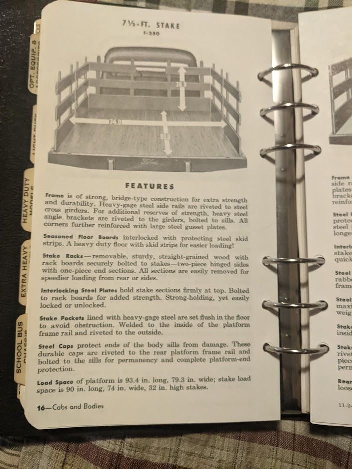

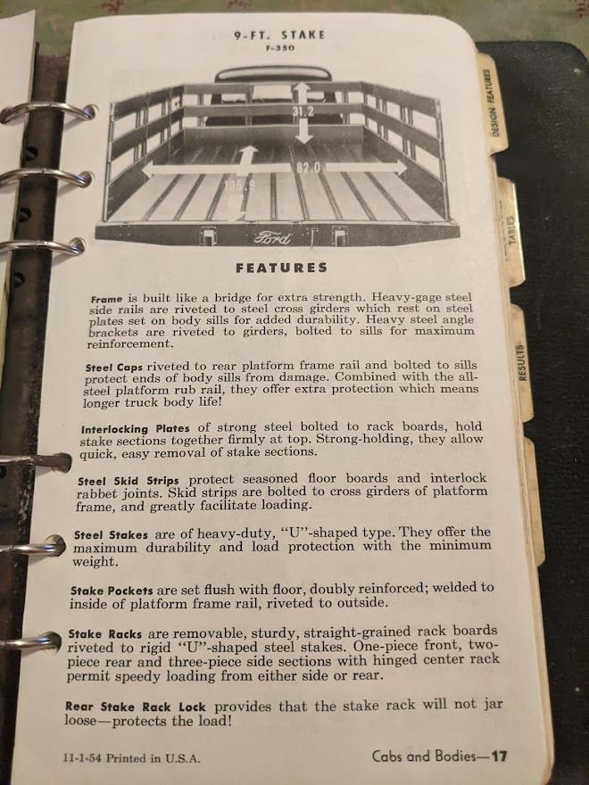

F250 and F350 flatbed specs:
