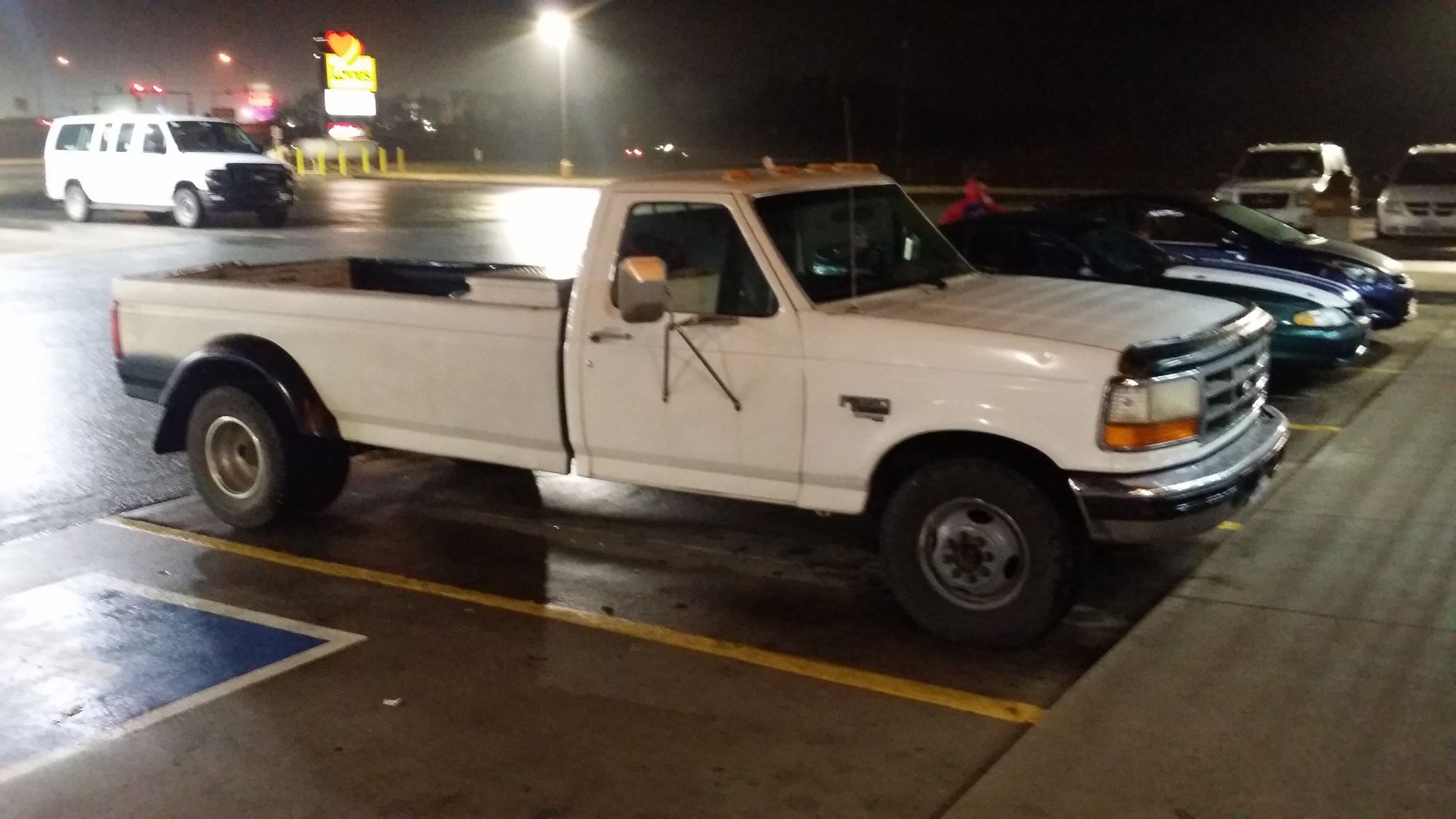

I saw a f350 in joplin,mo at the loves truck stop he made a 10ft. Bed it looks great, I'm doing the same thing for my 1969 f600 project just take a 8ft. Bed in good shape cut 2ft. Off a 6' or 8' bed and weld the 2ft section on the front. Since yours has duel rear wheels you have to cut out part of the bed floor to accommodate the tires he used a 55 gallon drum cut to fit to tub it out. I'm using both sets of original wheel wells with a spacer to fit.

He welded a 2ft section on a 8ft bed tubbed it and used f550 front fender extenders to make duelly fenders

That is a proper pickup truck! Love it.
