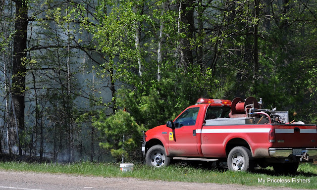

Here's a typical brush truck used by the DNR here in MN. Nothing out of the ordinary, just a stock F-350.
If they can't get where they need with those trucks, they bring in the J-5s.
