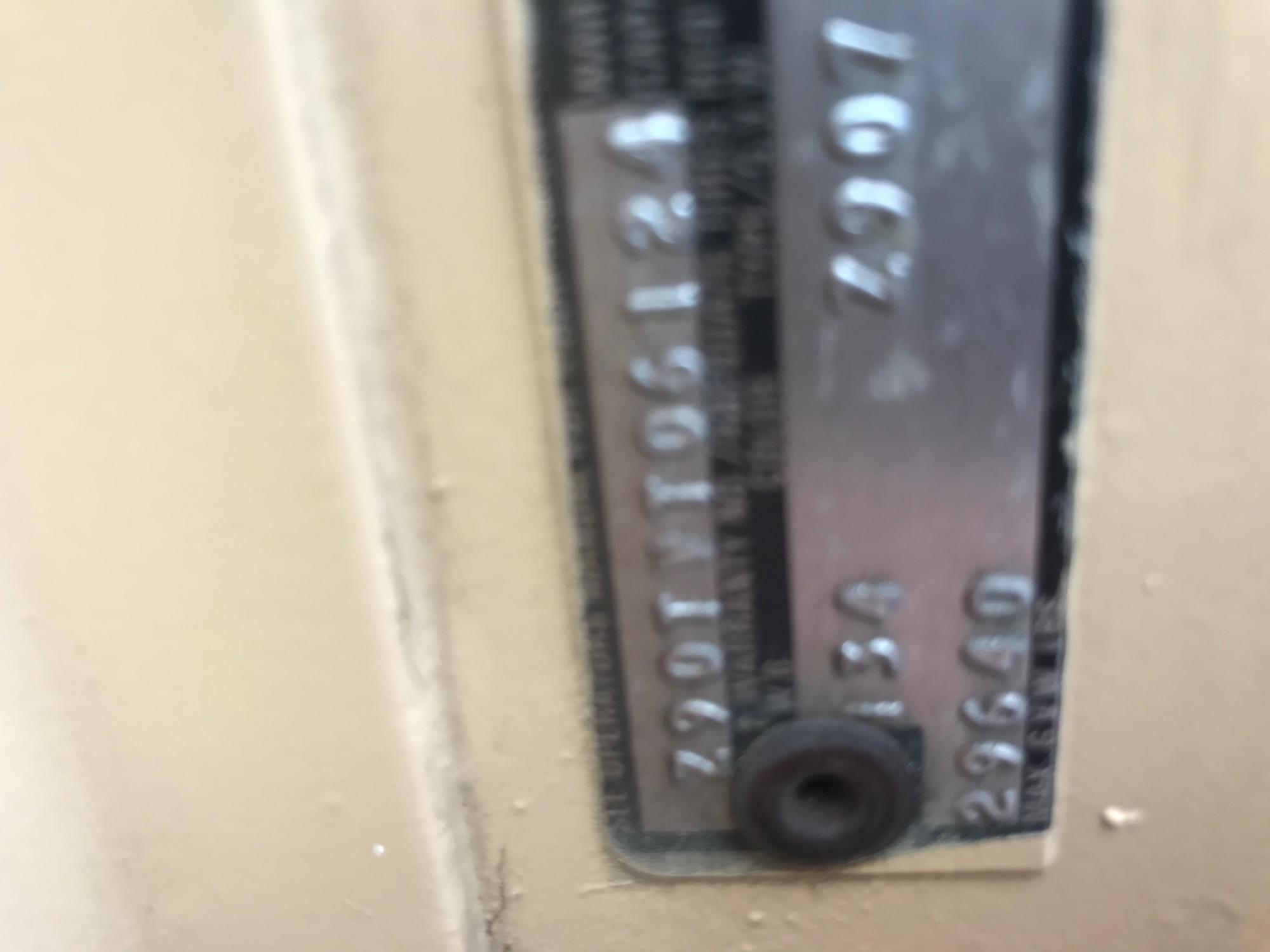

Finally got a half *** shot of the VIN tag.
Bill,
So with seeing that now, do I have it right with the following?
Z90TVT06124
Z90 = "73 - 77" W9000 Diesel
T = "73 - 79" 8cyl / 568 CID / Detroit 8V 71N
V = Kentucky Assembly Plant ( Is that Louisville or was there 2 plants in Kentucky? )
T06124 = it's a 1974

Z90TVT06124
Z90 = W900 Diesel.
T = Detroit model 8V-71N 568 cid 8 cylinder diesel.
V = Kentucky Truck Assembly Plant (500 and larger series trucks) // U = Louisville KY Assembly Plant (cars, light trucks).
T06124 = 1974
