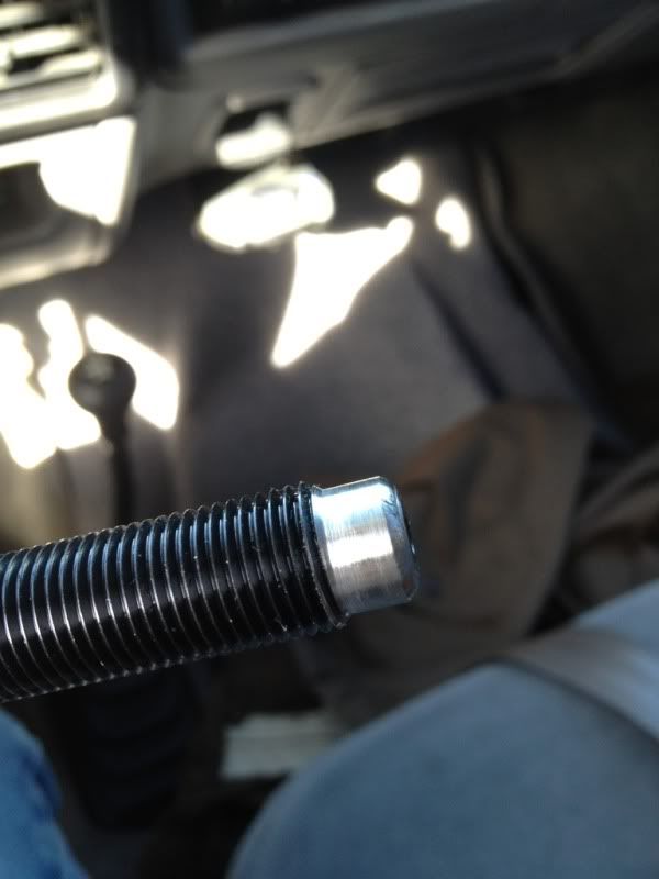

Slight set back. I'm going to bull nose the ends before I press them in. Guess the bull nose prevents the ends from getting messed up when the wheels go on. I'll update when I get them back and in. Might be a week since I'm on vacation next week.

Studs bullnosed. I'll press them and post a pic later.

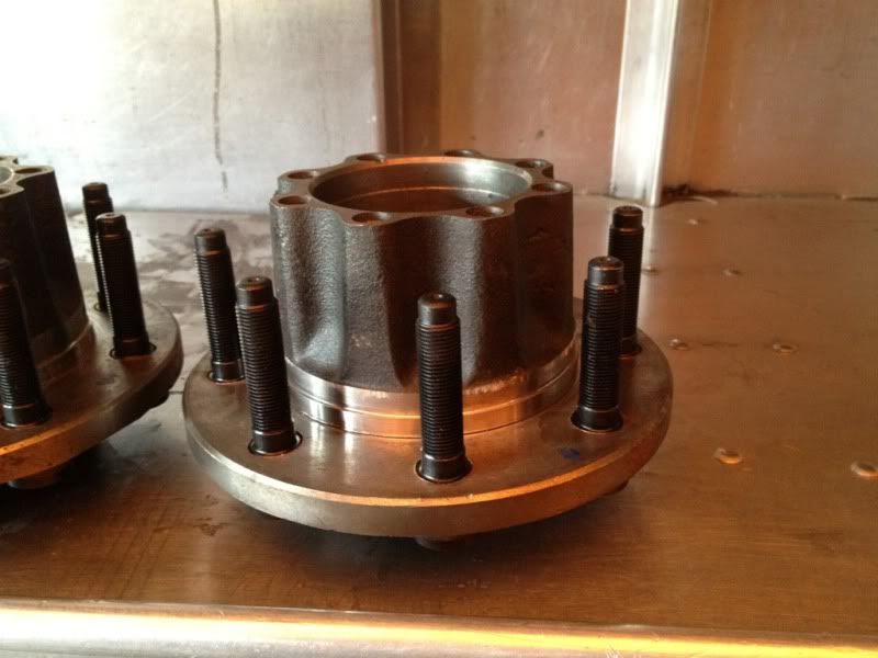

Machined to fit the obs wheels

That's a nice clean job. Would That also be required for running an old style lug centric 8 on 6.5" wheel?
Most all aftermarket wheels the center bore is much larger and this modification is not needed.
