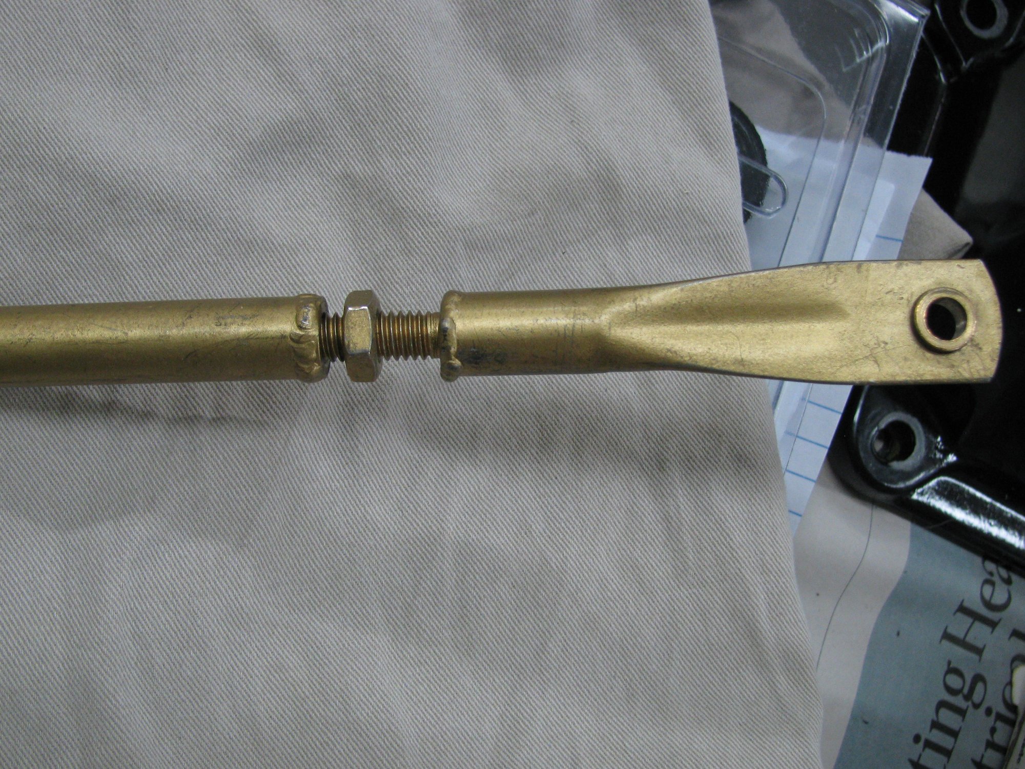

The kickdown rods are specific to each vehicle engine and transmission combination. They don't play well when mixed up. Short of buying a Lokar kickdown kit. Here is a old hot rodder trick to deal with going from a 2bbl to a 4 bbl. modify the rod so it is a little longer and adjustable.
